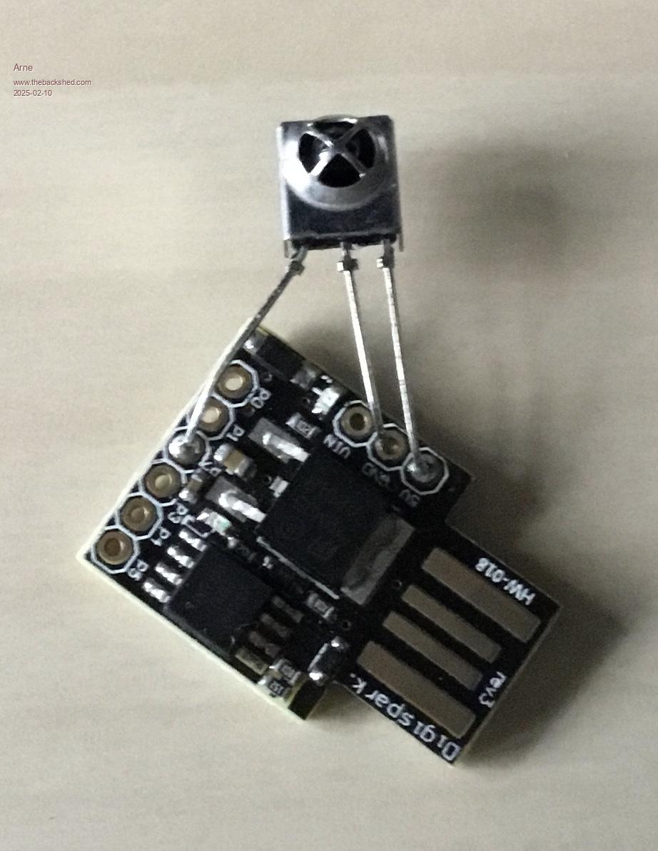

Now it is functioning on Picomite - USB too.
I changed some values in the usbconfig.h (VENDOR ID etc.) to data of my keyboard. After compiling the Digispark was detected as a Keyboard on channel 1.
Supported protocols are

Here a picture of the receiver :
