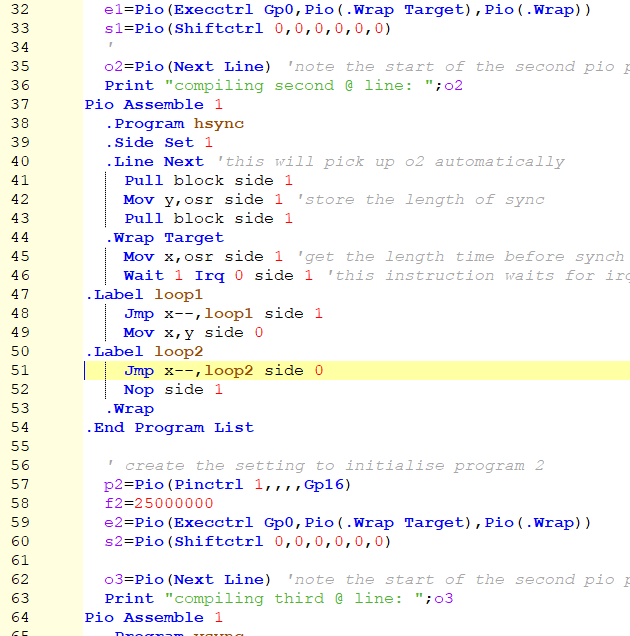

Posts: 6624
Posted: 06:27am 12 Feb 2025
A start with PIO formatting:
I will need to see a lot more code and the updated Appendix F, hopefully with a list of keywords.
