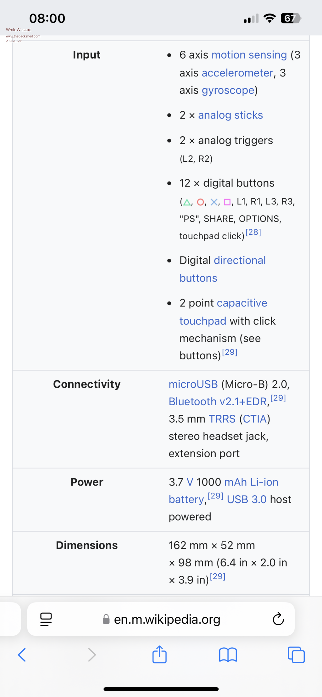

I am about to buy a wireless gamepad; however, before I spend too much money I am first wanting to ensure that whatever I purchase will definitely work with the PicoMite.
So, this is to ask if anyone out there has successfully used a WIRELESS gamepad with their PicoMite.
My preference is a branded version such as the one below. The manual refers to PS3 and PS4 controllers so I’m guessing it should work.
Any confirmation about experiences with this specific model, or indeed with any other one, would be great to hear about.

Hi Tom,
You are correct in that it has Bluetooth connectivity, but also in the specs it mentions microUSB too (possibly via a dongle?).

  WhiteWizzard said  ... but also in the specs it mentions microUSB too (possibly via a dongle?).
I'm not personally familiar with the PS 3/4 but if it is anything like the the PS 5 or various generations of XBOX controllers then there is a USB port on the controller allowing you to wire it directly to a USB port on the console both to charge the controller's battery and ALSO as a wired data connection.
Best stick to official wired PS 3/4 controllers as Peter said.

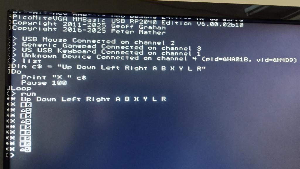

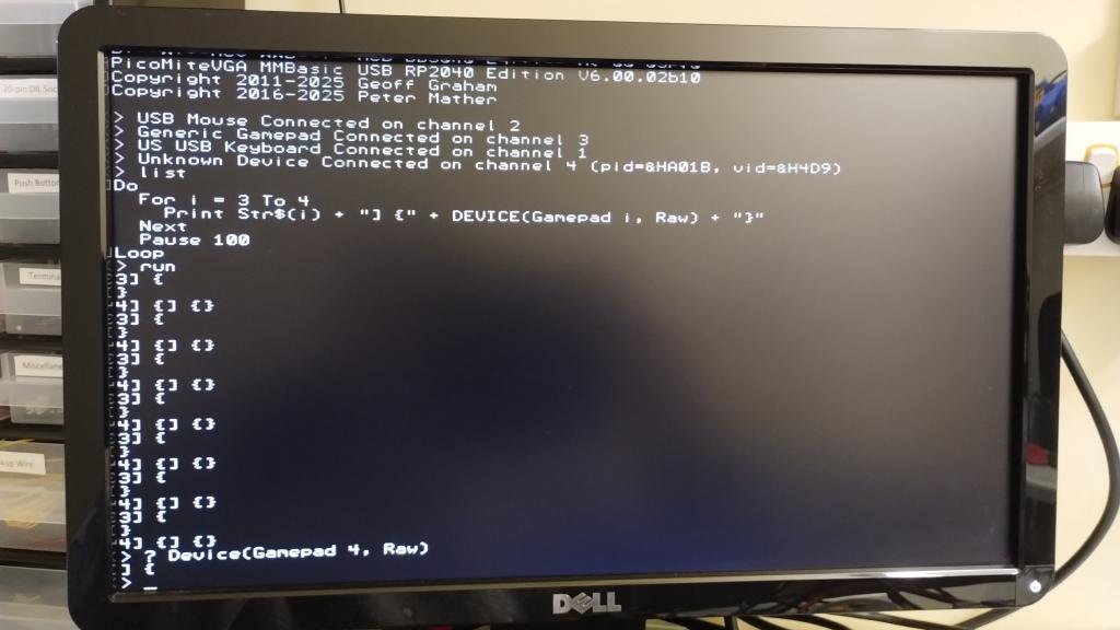

I'm away from home at the moment and don't have all my toys. In B10 there is a new function DEVICE(GAMEPAD n,RAW)
This returns a string containing the raw data returned in the USB report. For most controllers this will be 8 bytes long. Please could you have a look at this with your Buffalo and see if it works. The firmware polls the controller every 20 milliseconds so this value will update at that frequency.

Thanks Peter,
But unless I was misunderstanding your instructions something looks borked:
Note that I think the "Generic Gamepad" reported on channel 3 is a "hallucination" that having the keyboard attached is producing.

Posted: 11:34am 11 Feb 2025
Its binary data
Posted: 11:40am 11 Feb 2025
  matherp said  Its binary data
Ah, I thought it would be hex encoded ... I'll deal with it ;-)
Posted: 12:14pm 11 Feb 2025
Sorry Peter, but unless I'm having some sort of psychotic break there is something both a bit "fu" and also more than little bit "bar" in this firmware:
Something is tramping over c$

Posted: 12:31pm 11 Feb 2025
OK I think I understand. I'll post an updated test version for you VGAUSB RP20240?
Posted: 12:35pm 11 Feb 2025
