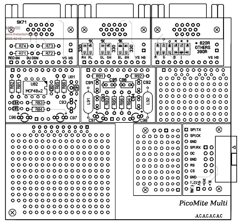

If you only ever build one PicoMite compatible system it may well be this one. :)
PicoMite Multi Construction Pack.zip
This is the result of an idea from one of my previous posts.

Perhaps I didn't say e-nuff....

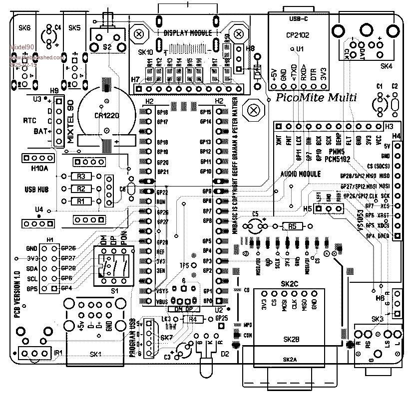

Yeah, same old Pico on a 100x100 board. Yawn. This on gives you a choice of just about any pin-compatible Pico clone, a choice of display and audio systems and the opportunity to create your own of either. Throw in a 4-port USB hub, PS2 keyboard socket and IR receiver and it just gets a bit mad. :)
It makes an interesting test rig too. Just plug together the system that you want at the time, load the appropriate firmware and off you go. Doesn't matter if it's just a Pico or a Pico 2 with HDMI, the same board can be reconfigured at any time to do both.
Of, the padboards have the pads linked into strips bt thin tracks underneath. Treat them like stripboard with the advantage that you break the strip between the holes instead of at them. The strips aren't connected to anything, that's up to you.
Have fun. :)
