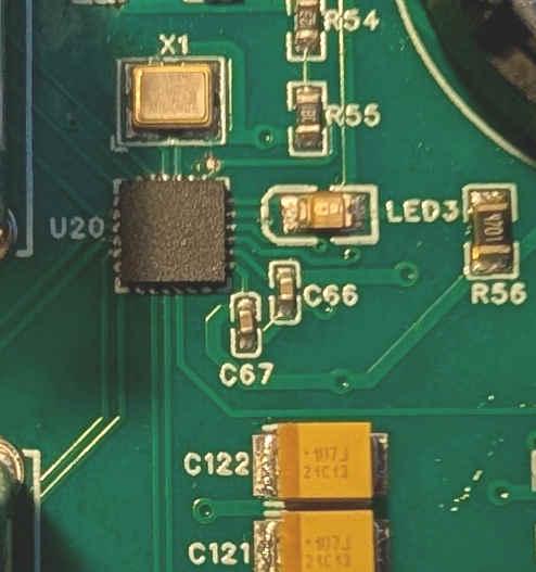

I've just received my batch of the updated reference design with the RP2350B onboard.
As in the original this board includes a CH334F 4-port USB hub. More than 5 orders have been placed using this chip all of which work perfectly. However, the hub in the boards from birefringence's recent order didn't work. My hub also doesn't work. I have moved a known good CH334F from a working board and soldered it to a board from the current order (not easy).
This now works. I then soldered the suspect CH334F to the known good board and that no longer works. Taken together with the evidence from birefringence's order, it appears that there is definitely a bad batch of CH334F.
I've filed a complaint with JLC who will contact LCSC and will wait to see what happens. I'll report progress here.
In the meantime I would recommend not ordering and boards using this chip from JLC.

Ouch, I did not see this thread before I ordered 5x assembled HDMIUSB boards through JLCPCB. The USB hub on my board is not working. I can get USB functionality by using an OTG adapter in the PROG port, though. Is there any suggested rework that can fix my boards?

Posted: 06:12am 25 Mar 2025
You can try to remove R54 and R55. This worked for me. It will disable the over current detection of the USB controller but should have no other side effects.

  Quote  It seems Silicon Chip have bought a bunch of these boards too. No word of a solution yet…
Silicon chip have been appraised of the issue and will be removing R54 and R55 before shipping. As birefringence says this just disables the overcurrent detection but as the supply is also fused (resetable) is completely benign. There are variants of the CH334 without this protection so this feature is just a "nice-to-have".
My design for the RP2350B, just released, continues to use the CH334F but with the overcurrent protection circuitry removed from the design (no R54/R55)
It appears the parts are completely genuine, just a batch with different (wrong) characteristics.

Posted: 04:41pm 25 Mar 2025

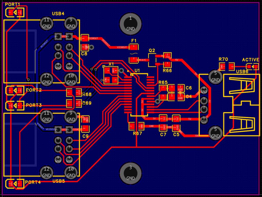

For info, I've designed a 4 port hub based on the FE1.1S and ordered some from JLC. Assuming this plays nicely with the PicoMite I'll update the designs using this chip.
Schematic
a7431364-ab62-47da-9336-dd0b182ab3b9.pdf
