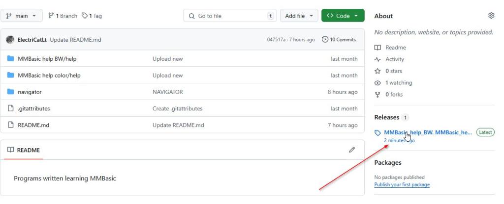

I also could not download from github (until I went up the tree to ElectriCatLt/MMBasic).
electricat
Joined: 30/11/2020
Location: Lithuania
Posts: 299
Posted: 03:03pm 14 Apr 2025
Oh..
I added releases for more easy download.

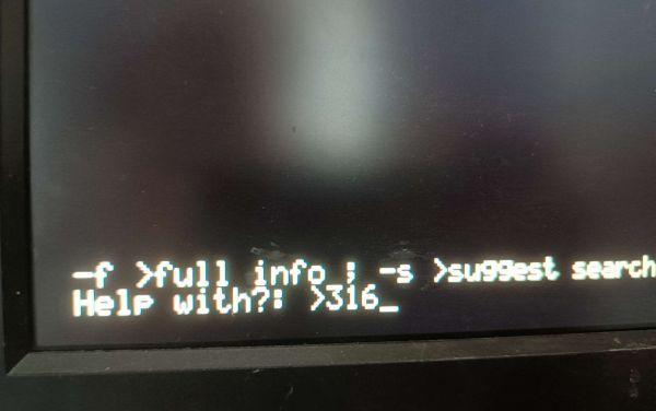

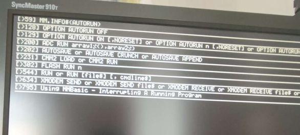

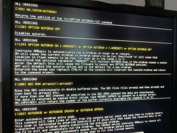

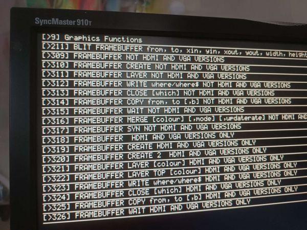

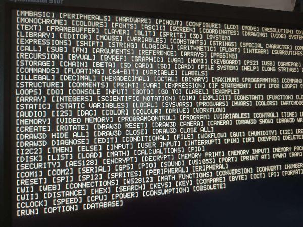

I wanted to capture how it works, but went into focusing problems, so some screenshots here.
effect if entered RUN as search keyword without any keys
search with key -f (lists full info)
BW version. Ok.. not totally BW, all BW except short description

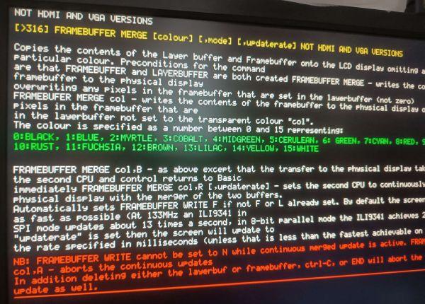

Effect if entered search keyword FRAMEBUFFER (fithout -f key)
and you can read more detailed on topic entering >316
Colour version of >316
effect of just key -s
if there is no ideas what you are looking for

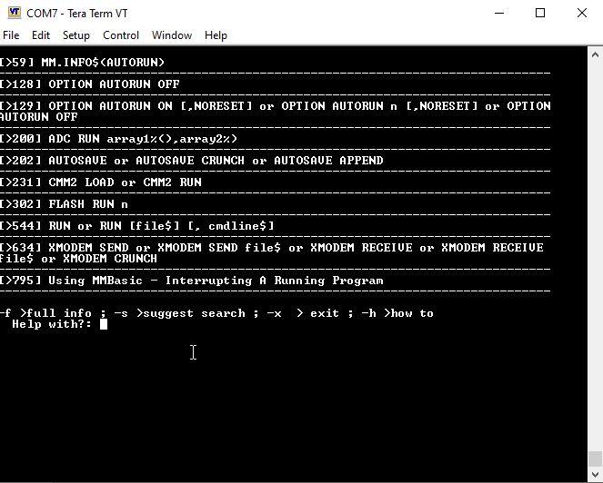

Only Ctrl-C helps here via Console (I have no keyboard, only a mouse connected for testing!)
The correct output on the console (e.g. TeraTerm) would also be ingenious. Unfortunately, it appears confused.

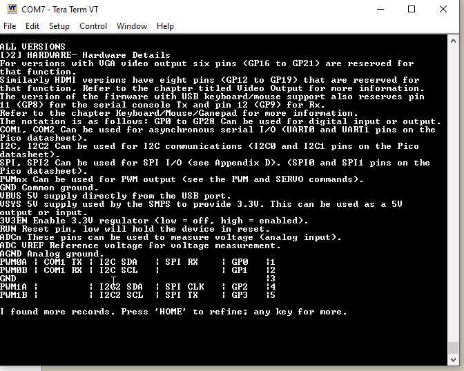

- There is quick terminal/ headless/RP2040 compatible version
So output to VGA screen would be quite ugly, while somehow usable still.
help_console_RP240_headless_20250416.zip
- Now all keyboard sents should work ok through terminal (no need external keyboard)
Will not return path however. Have no any ideas how to do it, yet.
You can change pair of vars to your taste at the beginning of prg. if you want:
Dim integer max_prn_lines=29 ' for terminal height
Dim integer def_LineWidth = 80 ' for terminal width
