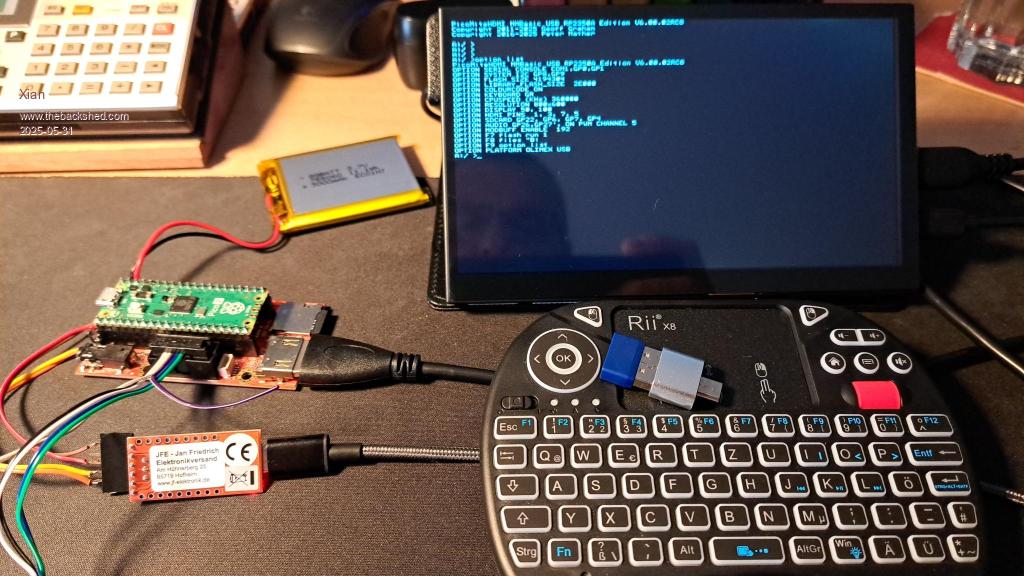

Hey There,
as you can see from the picture, basically the Olimex board with a Pico 2 is working fine. The HDMI monitor is working fine - however, i have no clue, how to add a keyboard, so that i could make the boot to BASIC computer portable.
Are there any solutions to connect a USB keyboard on a different way? I obviously underestimated this part of the project.
Any suggestions/links/whatever is highly appreciated.
Thanks,
Christian

It's possible to connect a keyboard or a non-powered hub to the USB port of the Pico, using the HDMIUSB version of MMBasic. You lose the console connection, so this has to be replaced by using a USB-TTL converter fed into a COM port of the Pico. The Pico can't have a second USB port so this is the only way.
It's also possible to connect a PS2 keyboard, using two pins for PS2__CLK and PS2_DAT.
There is also one I2C keyboard that can be used.
Posts: 3412
Posted: 01:06pm 31 May 2025
I see you already have a USB/Serial adaptor for the console, leaving the Pico USB port free to act as host for a keyboard.
Sitting on your keyboard is what looks like a suitable adapter for a keyboard to plug into the Pico.
A basic no-frills USB keyboard should work but the minimalist USB implementation that will fit on a Pico doesn't support keyboards that require extra USB functions.
Some wireless ones will work, others not.

hi Christian. I got a keyboard like yours with a wireless usb dongle. It doesn't work. check it on a win pc first!
As Mick said you need a usb to ttl converter using rx,tx,gnd for connection to pc.
a usb kb with mouse pad and mine got a laser pointer and a usb wireless dongle and hdmi usb version for 2350.
your supposed to power the olimex board usb 5V and kb plugs into 2350 pico.

Looks like you have everything needed, can you please confirm you have 5V on 5VUSB(pin40) of the RP2350?
Can you plug a normal USB keyboard in to test?
If not, link VUSB(pin40) and VSYS(pin39) to power the USB dongle, hopefully this gets it to work. You may need to check the schematic for the board.
I have a different Rii keyboard / Touchpad (K12S) and unfortunately it doesn't work direct into the PicoMite for the reasons explained above, however I and others have had success with PS2x2 on a second Pico via the PS2 keyboard interface.

the 5V is making the difference. It is workikng as soon as i power the Olimex board with a 5V powerbank. Which is perfect. Now i "only need to find a decent housing.
My wireless keyboard is working perfect - had tested it before. I was assuming the battery power (3.7V) got stepped up on the Olimex board, which is incorrect. Looking at the circuit sheet i saw this only.
Thanks for the hints to all of you!

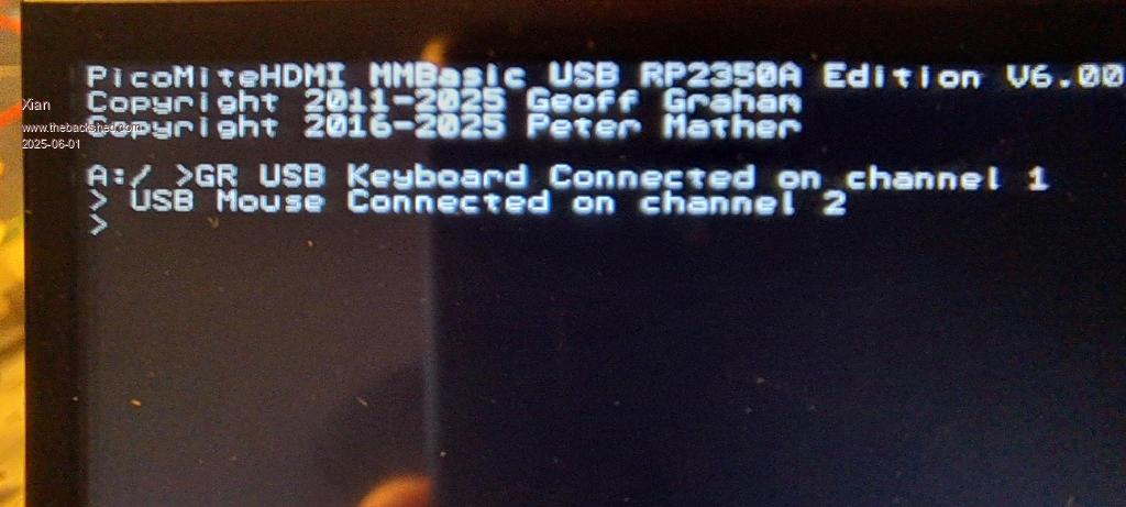

Footnote added 2025-06-01 01:59 by Xian
seems even the mouse-trackpad of the keyboard is recognised. So good to go now.
