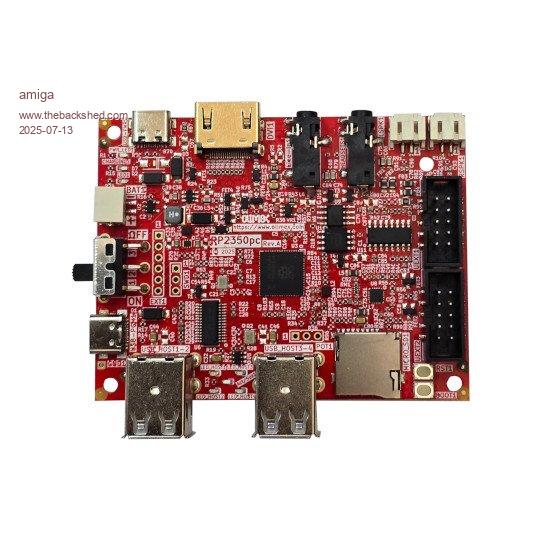

i all folks,
there is a new board for PicoMit cost +/- 25€ .. without tax and transport !
https://www.olimex.com/Products/RaspberryPi/PICO/RP2350pc/open-source-hardware
have nice day or sleepy night,
amiga

I've just been having a look at the circuit - probably one of their better efforts. They've used GP8 for PSRAM select but then lost two of the ADC pins by using them internally anyway. :(  Do these people not realize that having the availability of 8 ADC inputs is actually a "big thing" for this sort of board? By all means bring out the battery voltage and external power detect to pins - the user can decide whether or not they need monitoring.
The power supply looks like the RPi recommended switcher, I wonder if they've got it right and this thing will overclock? What's the betting that it reaches the RPi spec and not much further?

he RP2350 is a bit of a red herring as Raspberry Pi only produce a board with the RP2350A on it, not the B version. AFAIK only Peter's design can overclock the RP2350B sufficiently for the DVI displays that the PicoMite uses, and that's only by replacing the switching supply with a linear one, Whether this Olimex board can manage it with a switching regulator is still unknown.

Has anybody got MMbasic working on this board?
I have installed the firmware file PicoMiteHDMIUSBV6.00.03.uf2 on it.
It does start and prints a "P" to the top left corner of a connected HMI screen, but then hangs.

Perhaps it is starting to print the PicoMite version info.
Have you been able to set up the serial console?
If so you can see if it is the Pico that hangs or the HDMI screen not being compatible.
Others have had to try different screens to find one that works properly with the DVI-D over HDMI from the Pico.
If you don't have the serial console working install the non-USB firmware so you will have the USB console available to diagnose the problem.
Later you can install PicoMiteHDMIUSBV6.01.00b15 from the "PicoMite V6.01.00 betas" thread. It has a number of bug fixes.

…but based on a very quick look they are using GP8 as the PSRAM chip select. By default the USB versions assume there is a serial console on GP8/GP9. If my assumption is correct, as soon as MMBasic outputs the copyright message on GP8 it is going to select the PSRAM and corrupt the QSPI bus.
I can't think of a way round this without you compiling a variant with the serial console changed to another pin. You would do this in the function ResetOptions in fileio.c. Make sure you clear the flash before trying to install the firmware variant.
All other boards I've seen put the PSRAM select on either GP0 or GP47 so this one is an oddity
I will try to recompile and report back here

Why doesn't it surprise me that it's Olimex? The same company that put audio on two different PWM channels on another board? Crazy pin spacing on another? The CH334 problems? Peculiar HDMI pinouts? I give them points for trying but not for succeeding.

I am not affiliated with them, but it certainly seems nice that they sell these boards for reasonable prices (in Europe) and they seem to care about open documentation and community building.
I am not aware of a similar board with multiple USB-A sockets

I get used to designing my own boards. :) It's nice to just build in the facilities that I want at the time. Four USB-A sockets is easy enough for me to do now. I've published a couple of designs on this forum now.
I'm not saying the Olimex stuff is bad, it's just unfortunate that it's had compatibility problems with MMBasic in the past. It's fine if you are programming in C or Python and can draw on suitable libraries. Note that this applies to a lot of other boards too! MMBasic isn't one of the languages that many board designers test their hardware with.  :(  However, the demands of MMBasic aren't high or particularly specialised. There are sensible defaults or GPIO pins can be redefined to fit most situations.
