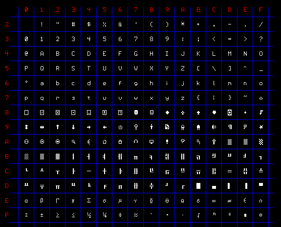

Using font 1, chr$(&h92) to chr$(&h95)
https://www.thebackshed.com/forum/ViewTopic.php?FID=16&TID=18132#242212

Font1 table here:

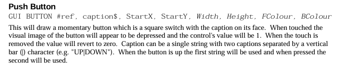

According to the manual, the button works like this:
