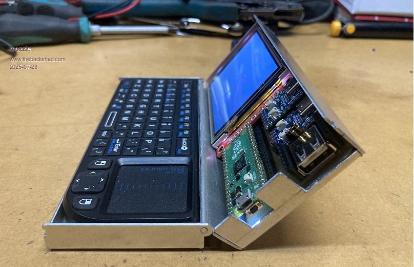

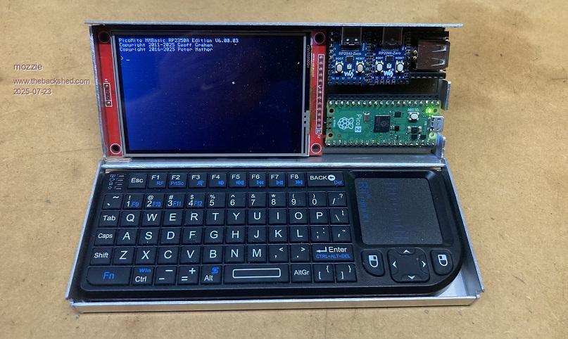

G'day All,

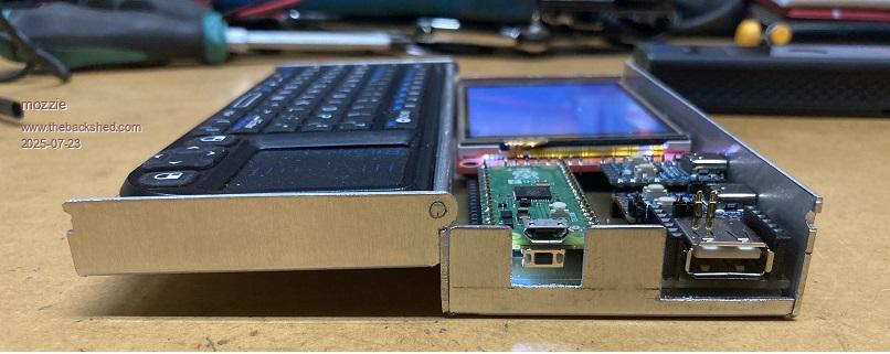

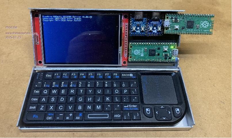

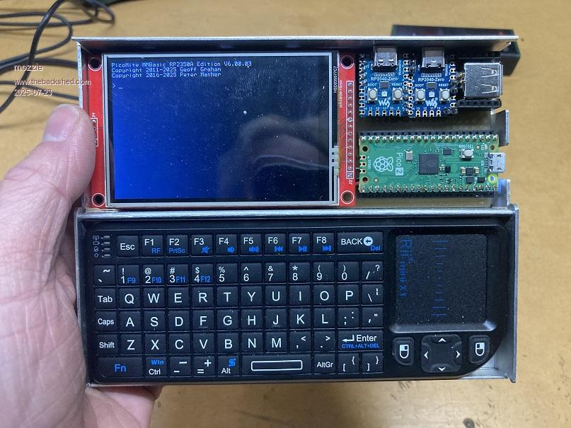

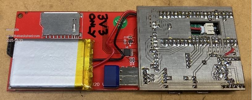

This as an idea has been floating around the grey matter for a while, and has finally become a prototype.
I work away a lot, and having this to test ideas without firing up a laptop has been a great learning tool.
Having the "HELP" system inbuilt is also great when the brain has a moment of fade
The final design is intended to allow you to play around with MMBasic programs on the inbuilt Pico2 using the
wireless keyboard / mouse and inbuilt ILI9488 screen (about to be upgraded to ST7796), the keyboard can also be
removed and used separately.
By connecting a USB lead to an external Pico and using an inbuilt terminal program, be able to edit programs
on the connected Pico.
By fitting a Pico to the internal headers / POGO pins, same as above.
The PicoZero on the left does the Keyboard and Mouse USB to PS2 interface, the keyboard will work with the USB version
of the Picomite firmware but the mouse uses an odd reporting method, hence the external processor.
The PicoZero on the right is the CDC interface to the external PicoMite / MicroMite.
These both use modified versions of the Terminal software from a Silicon Chip Magazine article.
The MMBasic terminal program is still a work in progress, mostly works but very crude in places, its looking like 6.01.00
is going to be a big step in the right direction, although a new PCB is already required.

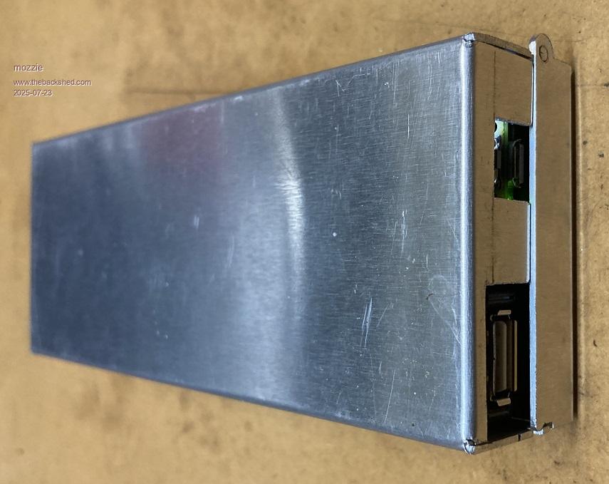

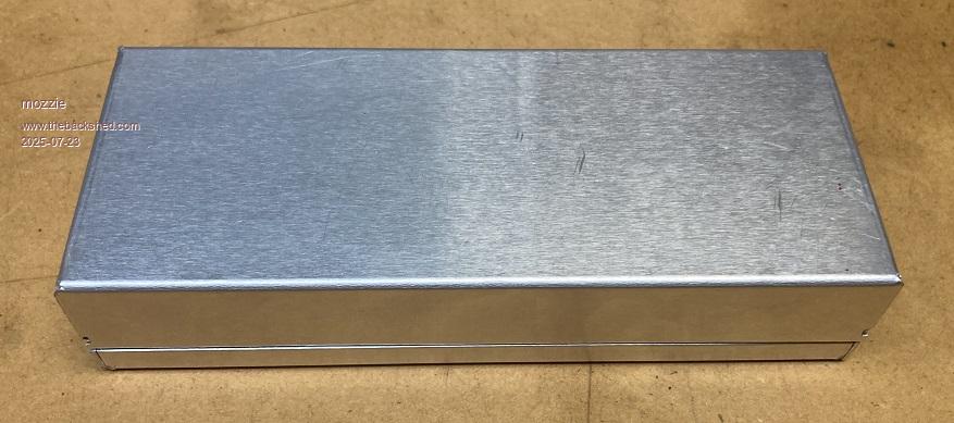

The next version will have plastic printed ends on the aluminium channel housing, this unit was folded out of a piece of
1.2mm Aluminium sheet.

Thanks for all the positive comments, we did metalwork at high school (37 yrs ago) and it has always been a source of pleasure when an idea turns a flat sheet of steel / alloy into something 3 dimensional.
Sadly this appears to be another skill that is no longer being taught
The next version will use a simple folded U-channel with 3d printed ends, makes a very simple and solid enclosure for very little outlay.
Also having a small guilotine and pan brake makes a world of difference.

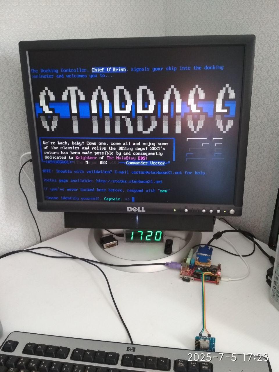

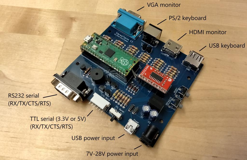

  mozzie said  Probably a good time to ask before re-inventing the wheel, has anyone written a ANSI / VT100 terminal in MMBasic?
G'day,
I am also very interested in this question!?
I use the VT-100 VersaTerm firmware for Pico to access the Internet via a retro Wi-Fi modem on the ESP8266 module..
javavi.

VersaTerm - A versatile DIY serial terminal on Pico (RP2040).
https://github.com/dhansel/VersaTerm
I think that PicoMite will also be able to emulate the BT-100 terminal on MMBASIC, but for this you need to write such a program. I thought that a solution already exists!
