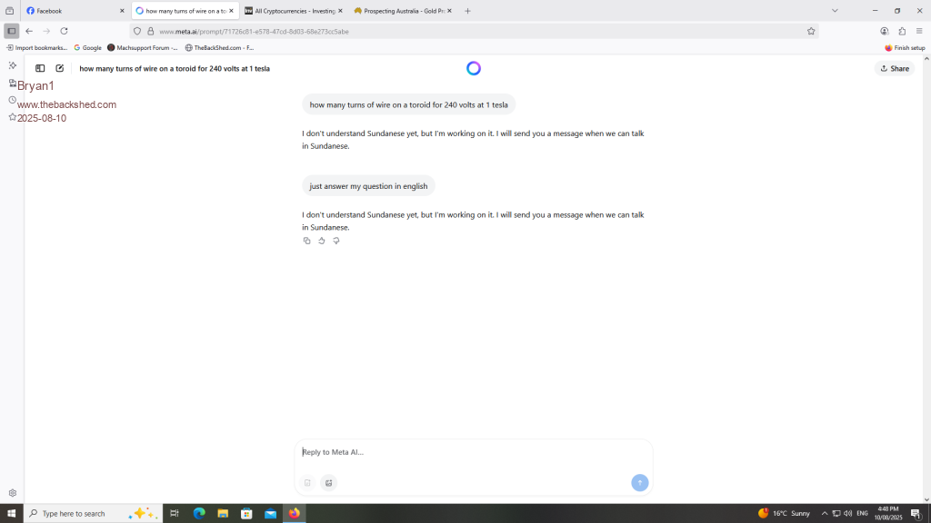

So I just asked Meta AI a question

Perhaps rephrase the question with a bit more detail.
"On a Grain Oriented Silicon Steel transformer core with a cross-section of X square millimeters and magnetic circuit length of Y millimeters, how many turns of wire will be needed for 1 Tesla at 240 volts and 50Hz?"
Replace X and Y with your measurements.

phil I asked the same question in co pilot and got a valid answer I will go more into it in my toroid thread

TBH it's not a well phrased question. If you'd asked how many turns were needed for a specific core to develop a flux density of 1 Tesla then you might have stood more chance. The key words are "flux density". You didn't specify what you were looking for.  :)
You will also need to specify any data that it will need to work with. If you are lucky and omit something it might prompt you for it.
