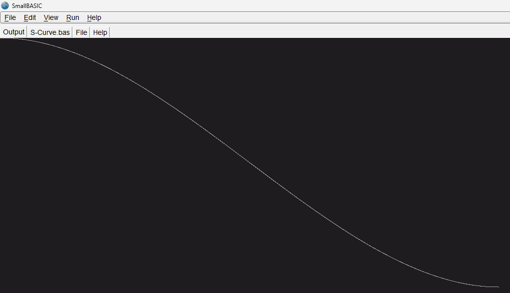

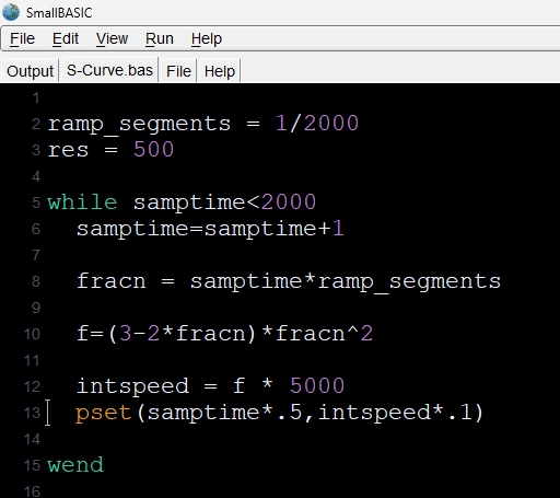

For someone elsewhere, I just had to prove that my S-Curve acceleration routine did in fact work, by generating a plot.
Look at any other solution out there because I haven't found one that isn't horrendously complicated
I know how to do this on the PC using SmallBASIC and so that's what I used.
Basic just totally rocks, I don't care about this "non standard" talk because modifications are usually trivial.

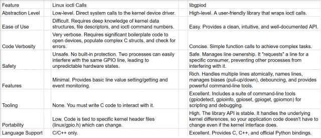

Posted: 12:02pm 21 Aug 2025
  matherp said  PIGPIO hasn't been updated in 4 years. This doesn't use PIGPIO but Linux IOCTL calls.
I asked Google Gemini to "Compare Linux IOCTL calls and libgpiod".
This gets to the core of modern GPIO interaction in Linux. Comparing raw ioctl calls and libgpiod is like comparing assembling a car from individual parts versus driving a fully manufactured car. Both achieve the goal of "transportation," but the experience, safety, and features are vastly different.
In short, libgpiod is the modern, recommended, and vastly superior way for user-space applications to interact with GPIOs. The raw ioctl interface is the low-level kernel mechanism that libgpiod uses under the hood.
Here is a detailed comparison:
Why would anyone use IOCTL now?
Posted: 03:18pm 21 Aug 2025
an old saying:
the only problem that can not be solved by adding a[nother] layer of abstraction, is the problem of too many layers of abstraction
each additional layer of abstraction (1) adds overall complexity, (2) consumes additional computing power, and (3) increases memory requirements. while it is certainly true that a carefully designed layer of abstraction may simplify the high-level programmer's job in some circumstances, in other circumstances it can do quite the opposite.
where appropriate i use IOCTL calls myself, to good effect.
in the case of the RPi the question is one of: how standardized are the I/O IOCTL calls vs how standardized are the PIGPIO calls? bearing in mind that, in theory, all I/O access goes via an interface with the binary "blob" - itself presenting a layer of abstraction. as Peter has noted variously in the past, PIGPIO for the RPi has presented him with a 'moving target' that continuously morphs to the extent of yielding an unmaintainable project. is IOCTL any better in the RPi case - who knows?
rob   :-)
Posted: 04:20pm 21 Aug 2025
  robert.rozee said  each additional layer of abstraction (1) adds overall complexity, (2) consumes additional computing power, and (3) increases memory requirements
In my experience as a programmer (since 1970), (1) is usually not true--abstraction behind the scenes (by others) simplifies the programs that I write, and Moore's law has made (2) and (3) fundamentally irrelevant in the vast majority of cases.
In the particular case of Linux running on current devices (even tiny ones), it's not likely often to be the case that computing power or memory requirements constrain one to use IOCTL rather than libgpiod (when available).
Concerning availability, the most up-to-date libgpiod is not available for installation on Raspberry pi using apt, but you can easily download and compile it. The next release of Raspbian (perhaps later this year) is expected to have the latest (later?) version of libgpiod, which is included in Debian 13 (officially released August 9).
