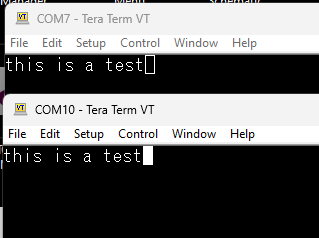

Just testing com0com on W11.
Installed without issue and works really well
Could be useful for linking MMB4W to some other app or have multiple MMB4W apps communicating....Multitasking MMB4W?

OK so I got two SmallBASIC programs talking. Only taken it up to a ridiculous 60M BAUD and it hasn't complained
