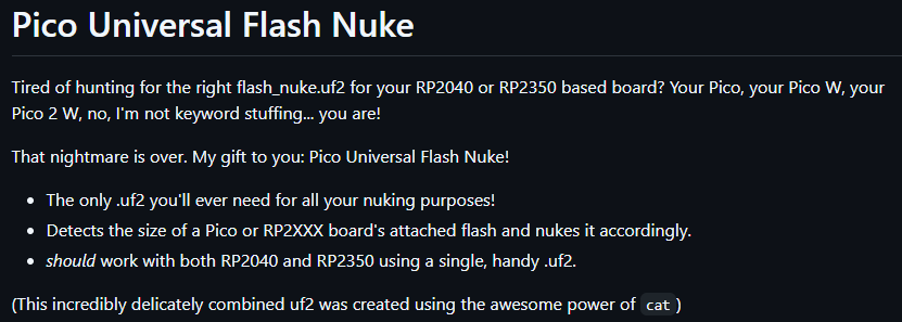

For both RP2040 and 2350

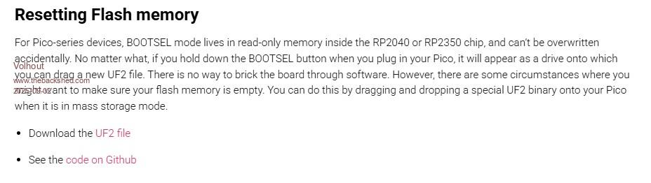

From the makers themselves..
Download here (bottom page):
here

Clear flash.uf and the one for the 2350 seem to work too

  Bryan1 said  Clear flash.uf and the one for the 2350 seem to work too
Yes. I asked ChatGPT to be sure I had the correct ones and it pointed me to the universal one. Works for me
