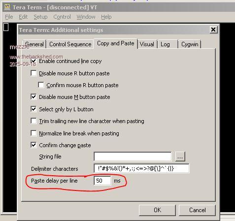

G'day Grogster,
If you go to:
Setup / Additional Settings / Copy and Paste
In TeraTerm there is a "Paste delay per line" at the bottom that may solve the problem.
Good luck.
Lyle.

Posted: 12:54pm 18 Sep 2025
G'day Grogster,
Did you try this?
If its set to 1000ms you can read the text line by line as it is sent.
This is TT4.100, hopefully exists in later versions.
Lyle.
Posts: 3322
Posted: 09:28pm 18 Sep 2025
  Quote  This is TT4.100, hopefully exists in later versions.
Yes, also in V5.2.
5mS works for me yet others find 50mS necessary so maybe the computer hardware or OS version make a difference.
