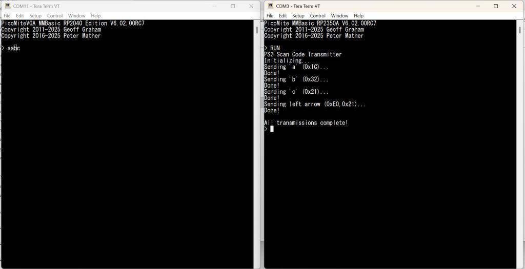

Posts: 11645
Posted: 12:18pm 16 Jan 2026
Posts: 11645
Posted: 12:21pm 16 Jan 2026
Typo on the picure. Should say 0xE0,0x6B for left arrow.
Here is the code. Needs RC7 to run. I'll post this later today
' PS2 Keyboard Scan Code Transmitter
' Uses dual bitstream with two pins in open-collector mode
' Simulates PS2 device-to-host transmission
' PS2 Protocol (device to host):
' - Clock: 10-16kHz, open-collector

spock57
Joined: 24/09/2017
Posts: 14
Posted: 08:46pm 16 Jan 2026
  JohnS said
Please give more info.
E.g. What sort of computer? Able to run/do what?
It may already be available.
I like to tinker I'm not really into computers I had something eight bit in mind. I actually still have a couple of Zx81's they fit the bill in as much as they were so limited and slow that the fun is trying to make them better, but I do not wish to risk damaging them. What I am describing is basically an executive toy I can mess with when  I am drinking endless cups of coffee in my local cafĂ© (I'm not a gamer, hand eye co-ordination rubbish).
There are plenty of simple AVR and pic single board computers and displays around, the stumbling block is most require a PS2 keyboard and they tend to be the size of a skateboard, a keyboard about the size of a A5 notebook that I could customise is what I was had in mind.
There is the M5 stack card keyboard but uses I2C protocol.
Any of the MM basic Micromites Maximites or Pico Mites would probably do great but I wanted to keep to a minimalist language like tiny basic or if I could find it VTL2 (very tiny language 2).
spock57
Joined: 24/09/2017
Posts: 14
Posted: 08:59pm 16 Jan 2026
WOW that was quick! I takes me months to write a couple of hundred lines of code I will need some time to digest this I am much in awe and truly grateful
Posts: 3321
Posted: 09:00pm 16 Jan 2026
' Transmit
Device BITSTREAM CLK_PIN, clkIdx, clkTiming(), 1, DAT_PIN, datIdx, datTiming(), 1
Two pin BITSTREAM !! Yes please!
Edit.
Already have a program that could use it.
Currently cramming clock and data and latch on one pin then using RC time-constants to separate them at the Rx end.
Edited 2026-01-17 07:11 by phil99

Posts: 3321
Posted: 07:04am 30 Jan 2026
Have been playing with Peter / Claud's PS/2 bitstream program.
Changing things to see what makes it tick and paring down some areas.
Sending scancodes to another Pico PS/2 console.
' PS/2 scancode receiver
Dim t=0, kb%=0
timer=0
do
  if mm.ps2<>kb% then
    print mm.ps2;
    t=timer
  endif
  kb%=mm.ps2
  pause 10
  if timer-t>5000 then exit do
loop
And the output. When the program times out after the last scancode the keyboard buffer passes it all to the console, which then executes it.
18 77 61517 45 67 49 44 41 18 82 27 61467 33 28 49 41 33 68 35 36 41 44 36 27 44 18 82 61522 90 61530
> Print "Scan code test"
Scan code test
The modified scancode sending code.

'Dim integer txt(33)=(18,77,240,18,45,67,49,44,41,18,82,27,240,18,33,28,49,41,33,68,35,36,41,44,36,27,44,18,82,240,18,90,240,90)
Print "Sending SCAN CODE TEST"
Math v_print txt()
For n=0 To 33
  PS2_Send txt(n) 'Works Ok to another Pico PS/2 console input, with or without pullups.
  Pause 50
Next
Print
Print "Sent"
End
