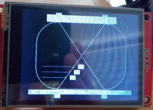

This has worked for me with the RP2040 before, but this is with an RP2350.
SAVE IMAGE "RR-1.bmp" produces this image when sent with XMODEM S "RR-1.BMP"
Photo is:
(Or I'm doing something wrong.)
