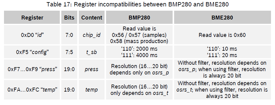

Posts: 6624
Posted: 09:12pm 16 Feb 2026
You have a BMP280
not a BME280
Chip ID for the BMP280 is 88 decimal = &h58
The BMP280 uses the same registers for temperature and pressure which is why you are getting readings for those.
Edited 2026-02-17 07:14 by TassyJim

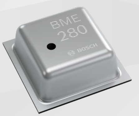

Posts: 3412
Posted: 10:46pm 16 Feb 2026
The type number should be engraved on the tiny metal box.
Posts: 6624
Posted: 11:07pm 16 Feb 2026
Or with batch markings:
  Quote  This is the smoking gun. If you look at the BME280 datasheet, on Page 44, the markings for mass production devices is shown. The marking should be in the format ??? U? where the U indicates BME280. The final ? is only a P according to this revision of the datasheet as there is only one subcontractor, so the last two characters should be UP.
Comparing this with the BMP280 datasheet, on Page 41, the format should be ??? K?, where the last ? is either P, U, N, W. Thus KP, KU, KN, KW are all BMP280 devices.
