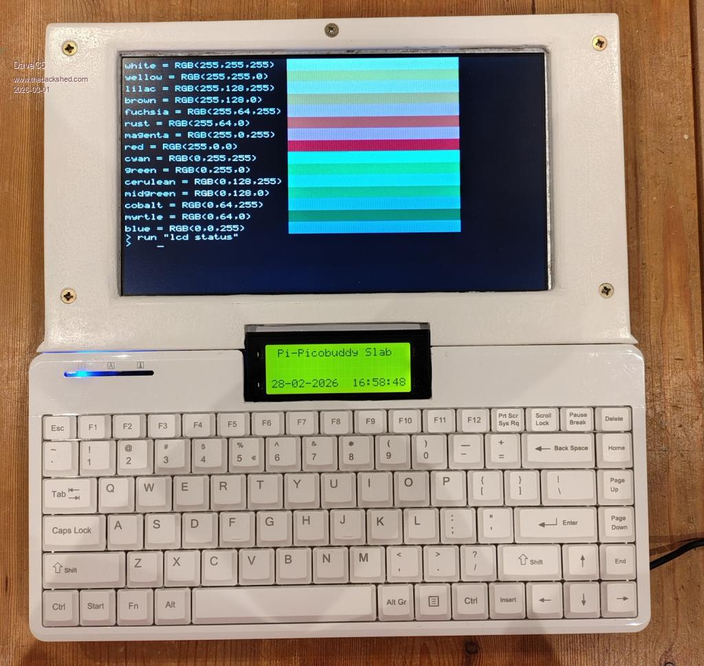

Afternoon all,
I got a bit fed up with working on a bunch of parts spread over the table, so I faffed about with some old MDF drawer-bottoms, a 10" car LCDTV, a Perixx PS2 keyboard and a Pi-Picobuddy board to make something a little more user-friendly.
I really wanted one of those Tandy TRS-80 Model 100's back in the day, and latterly got an Amstrad NC100 and a Sinclair Z88 to play with. The limitation was always the relatively small character display, and the slab format has its flaws, but I still like it for the nostalgic value and now I can pick everything up and carry it around a lot easier.
Dave

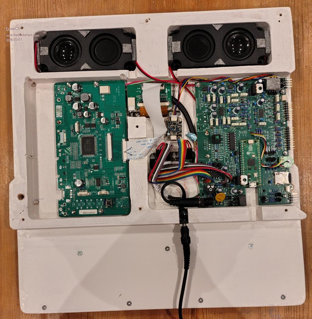

Is this HDMI and what resolution(s) are possible?
Edited 2026-03-01 03:47 by dddns
Posts: 3412
Posted: 08:49pm 28 Feb 2026
In the photo of the internals both the Pi-Picobuddy PCB and the monitor PCB have a VGA socket footprint but I don't see a HDMI one on the Pi-Picobuddy.

Hi,
It's just VGA. I have it set to 800x600, which is the native resolution of the LCDTV screen.
  dddns said  Super!!!
Edit:
DaveC5
Joined: 24/09/2025
Posts: 40
Posted: 07:28am 01 Mar 2026
Hi,
The LCDTV came with HDMI, VGA, BNC etc. interfaces, and the Pi-PicoBudddy only has a VGA output. To keep everything as compact as possible I removed all the unecessary connectors and hard-wired the necessary pins of the two VGA socket footprints together using a short length of cable salvaged from an old VGA lead, keeping individual screens etc. as intact as possible.
The slightly trickier bit was bodging on a "Source Selection" button so that the screen defaults to the VGA input, since I wasn't using the front-panel board from the LCDTV. It remembers the last setting, thankfully, but I've left the pushbutton as a recessed-access control just in case it ever forgets.
