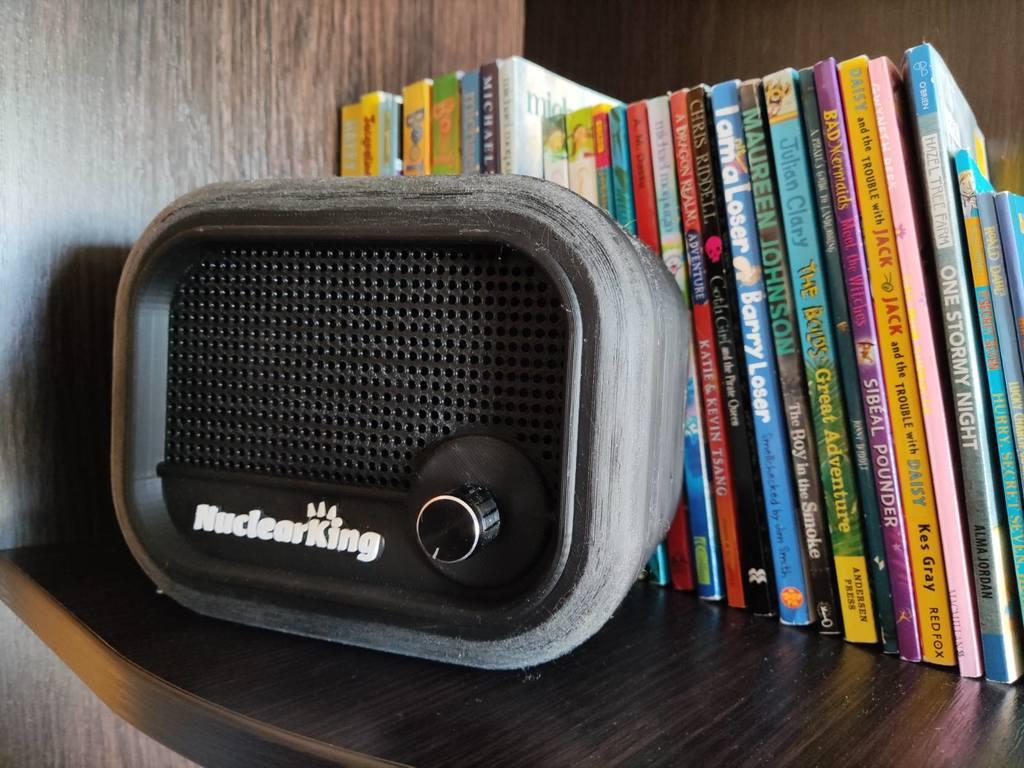

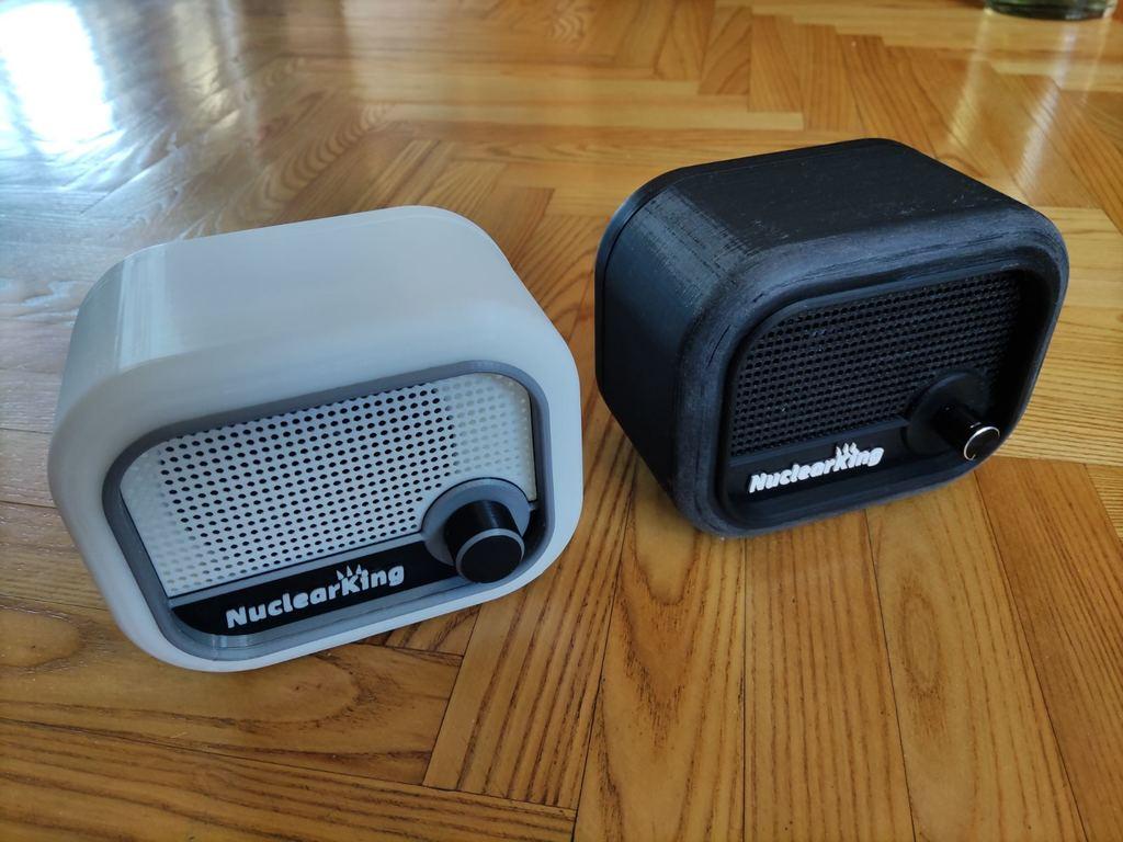

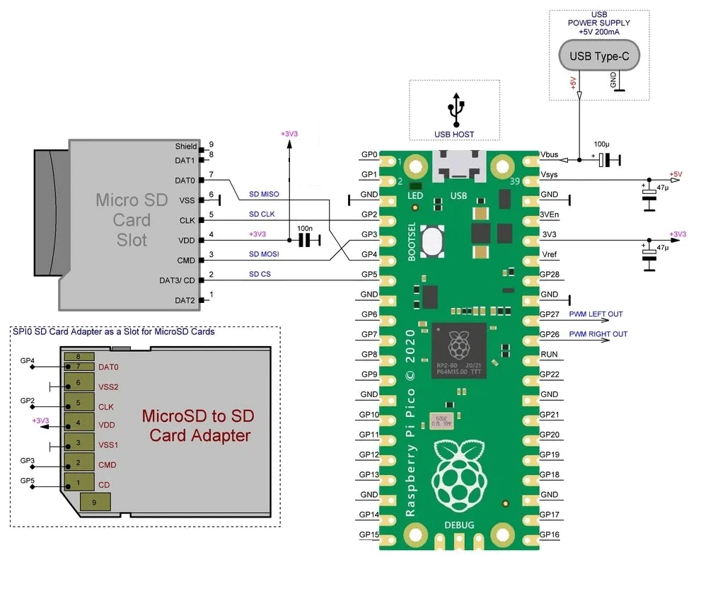

This is offline radio project that plays early 20th century records in random order, without the ability to switch or skip tracks. Like a real AM radio. To assemble the device, you need a Raspberry Pi Pico, a MicroSD card, an amplifier, 100 kOhm volume control with on-off switch and a 10cm speaker. Optionally, you can add a lithium battery and a TP4056 charging board to your project.
The player program is written in PicoMite MMBasic. All songs must be placed in the WAV folder in the root of the memory card. Files naming from 0001.wav to 9999.wav. I recommend MS ADPCM 22050Hz 4-bit mono WAVE format.
Optionally, you can create a folder with radio jingles called Jingles. In which you can also place files named from 0001.wav to 9999.wav. If the program finds jingles on the memory card, it plays them randomly once every 5-10 songs. I attached the jingles I created to the project files.
https://www.thingiverse.com/
This is a project of one of my community comrades whom I suggested to make this retro "radio" on PicoMite MMBasic

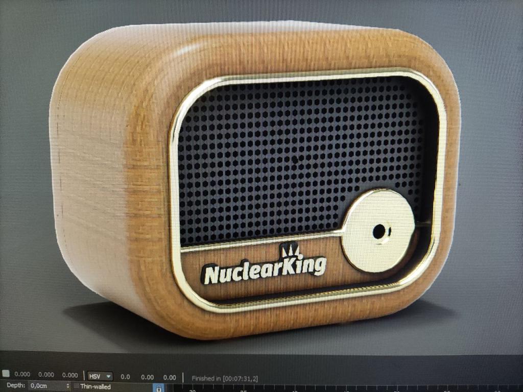

This is a project of one of my community comrades whom I suggested to make this retro "radio" on PicoMite MMBasic, рe decided to do this project on Pico RP2040, of which he has a lot, and for this reason the MP3 format was not considered.
I suggested using re-encoded music in FLAC format, but he decided that this project should reproduce monophonic audio with the quality of AM receivers of those years, and this is what he replied: It turns out PicoMite can handle not only PCM but also ADPCM files very well in WAV format. This allowed me to convert tracks to 22050Hz 4-bit mono MS ADPCM, averaging 2-2.5MB per song, in pretty good quality for a desktop radio station. So, offline MP3 radio turned out to be unnecessary for my project. The quality of recordings from the first half of the 20th century rarely reaches the limitations of this format, so I'm happy. Thanks for the tips. Now I'm starting to design the body.
There was also a proposal to build into this radio a “green eye” for tuning, like in old vacuum tube radios.
