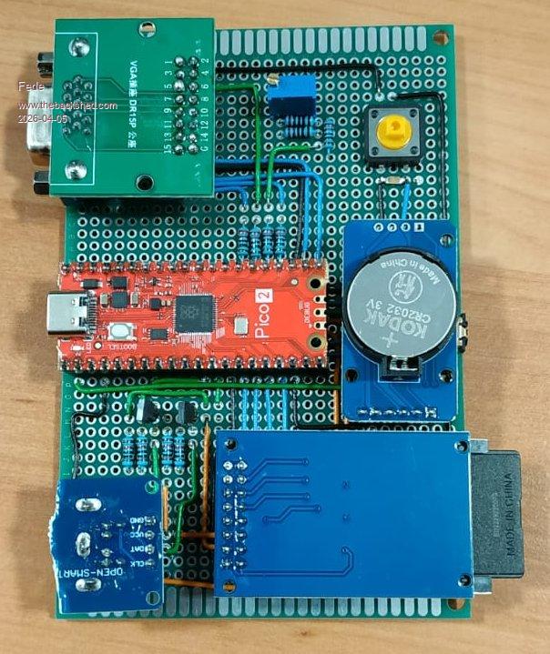

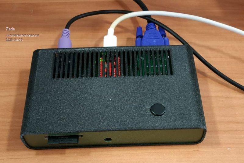

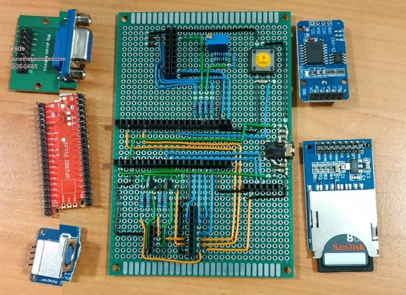

Fede
Joined: 09/03/2026
Location: Spain
Posts: 24
Posted: 06:00am 05 Apr 2026
Thanks. Thank you so much for the information.
I don't use PicoCalc much.
I program in the VGAPicoMite that I built myself and then check if it works in PicoCalc.
I find it more convenient that way.
And while we're at it, here are a few photos.
The bad thing is that my short vacation is about to end.
