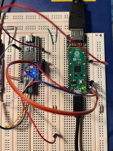

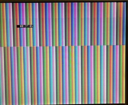

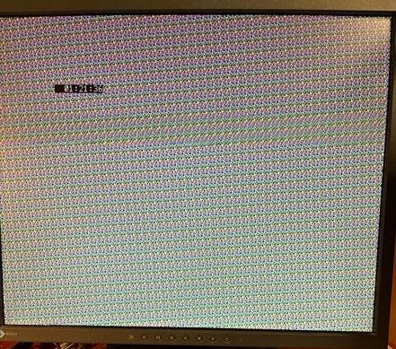

This is absolutely fantastic.
I hooked up my good old "Black Pill" STM32 board to the Pico2.
Spend an hour or so to get it running and now the STM32 can do HDMI :-)
The random output comes from the STM via the 4 bit Memory Share Link, while the time is displayed by the pico.
And now any MCU can have Bitmapped VGA or HDMI output using the Picomite as external graphics adapter with just 5 (or 9) pins.
Just for fun I'm going to try with a Picaxe and Basic Stamp.

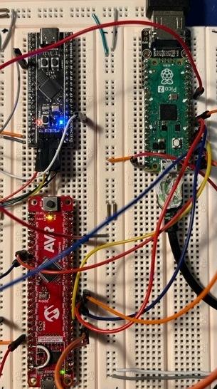

I love the Memory share function!
Memory share 8 bit link between an AVR and Picomite, the avr can write directly into the Picomite's screen memory.
Now even a good old 8 bit MCU can have a VGA/HDMI display without too much fuss :-)
