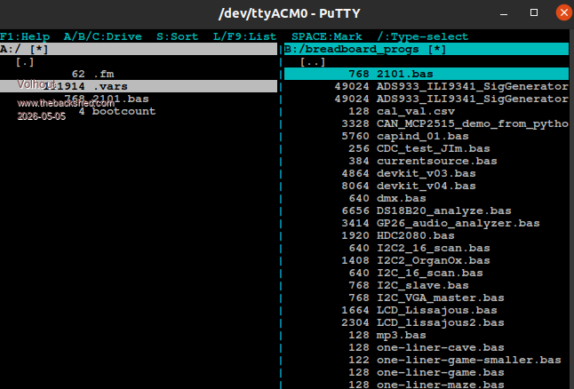

Posts: 6184
Posted: 11:58am 05 May 2026
@Peter,
60300rc0 2040VGA clean install
option VGA design 2
FM
edit (F2) any file on B drive (even a small 768 bytes basic program)
error: not enough heap memory
Posts: 12034

Posts: 6184
Posted: 01:49pm 05 May 2026
Observations on 60300rc0 (also second version):
1/ When there is a large program (i.e. 50k) in program memory, and you do not explicitly remove it with NEW, then open FM, select a file, then press F2 to edit, you get the "not enough heap" problem.
2/ When you get the "not enough heap" problem, a file called ".vars", size 131k,  is left behind on the A:/ drive.
P.S. I assume you need 132kb free on A drive to use the editor when in FM ? Maybe note that in user manual. Some may not have this luxury (Game*Mite).
Edited 2026-05-05 23:53 by Volhout
Posts: 12034
Posted: 02:02pm 05 May 2026
  Quote  When there is a large program (i.e. 50k) in program memory, and you do not explicitly remove it with NEW, then open FM, select a file, then press F2 to edit, you get the "not enough heap" problem.
Ah Ha - that was the clue
Try this
PicoMite.zip
