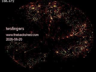

I commented out the memory pack/unpack code and am getting a displayed value of approximately 26.45 (at 315MHz); I just don't know if the output was affected.
With the Tracecache enabled, a cycle takes 25.7 ms (= 38.9 at 315 MHz).

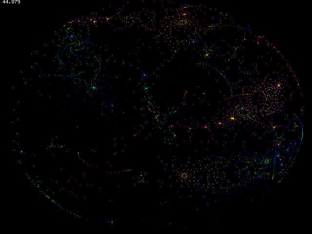

I launched Bubble Universe on CSUB steroids,
PicoMiteHDMI MMBasic RP2350A Edition V6.03.00RC21
OPTION FLASH SIZE 4194304
OPTION COLOURCODE ON
OPTION KEYBOARD US
OPTION KEYBOARD PINS GP2,GP3
OPTION RESOLUTION 640x480 @ 315000KHz
OPTION HDMI PINS  1, 3, 5, 7
OPTION SDCARD GP5, GP6, GP7, GP4
OPTION AUDIO I2S GP10,GP9', ON PWM CHANNEL 11
OPTION PSRAM PIN GP8
and here's the result for me:
MODE 1 -- 28.5mS 35fps
MODE 2 -- 27.7mS 36fps
MODE 3 -- 44.9mS 22fps
! MODE 3 worked only with the PSRAM connected
