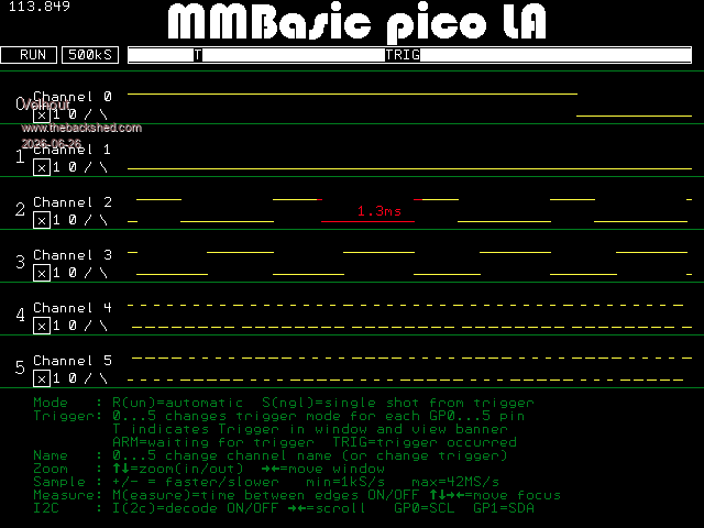

twofingers,
Depending on what you need the info for,, there may be a better way.
If you are running an MMBasic program, and need to know tile color, the best way is to remember, since your MMBasic program did set the tile color itself.
If you have a shared memory application: the PEEK above is your best solution.
But...if you want to work on this tile data from a PC there is another way.
- in the program that set the colors: SAVE IMAGE (or SAVE COMPRESSED IMAGE)
- transfer to the PC
- open the image in PAINT, PHOTOSHOP or your favorite picture editor
The SAVE IMAGE contains all color information. See below, a picture from 640x480 logic analyzer screen that works with tiles. As opened on the PC.
But you have to save from the running program. When you stop the program, tile information is not saved.
P.S. thanks to Peter, who added this functionality in 6.01, Tested on VGA.

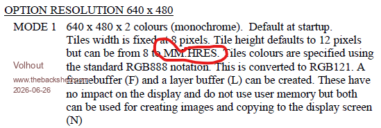

Posted: 08:56am 26 Jun 2026
Michael,
The tiles not necessarily are arranged as 80x40, since that implies tiles are 8x12. And they can be anything from 8x8 to 8x480.
That reminds me that there is an error in the manual (multiple locations, copy-paste).
tile height is up to MM.VRES (not HRES)
Edited 2026-06-26 19:02 by Volhout
