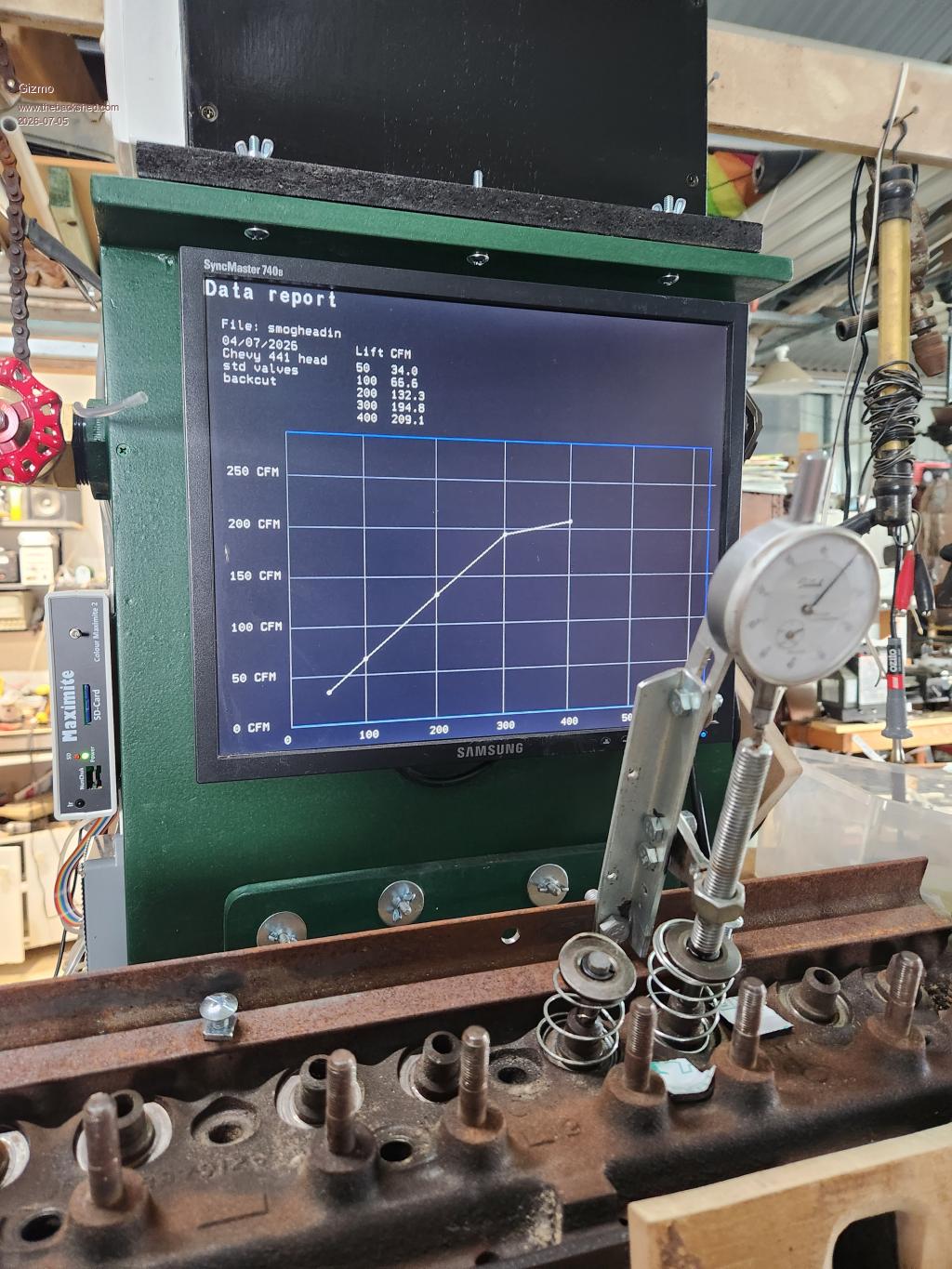

A flow bench is a tool used by anyone serious about getting more horse power out of a engine. The flow bench can tell you the CFM of a cylinder head, carburetor, exhaust, plus lets you measure or restrict flow in parts of the "port" to find turbulence, dead air, etc.

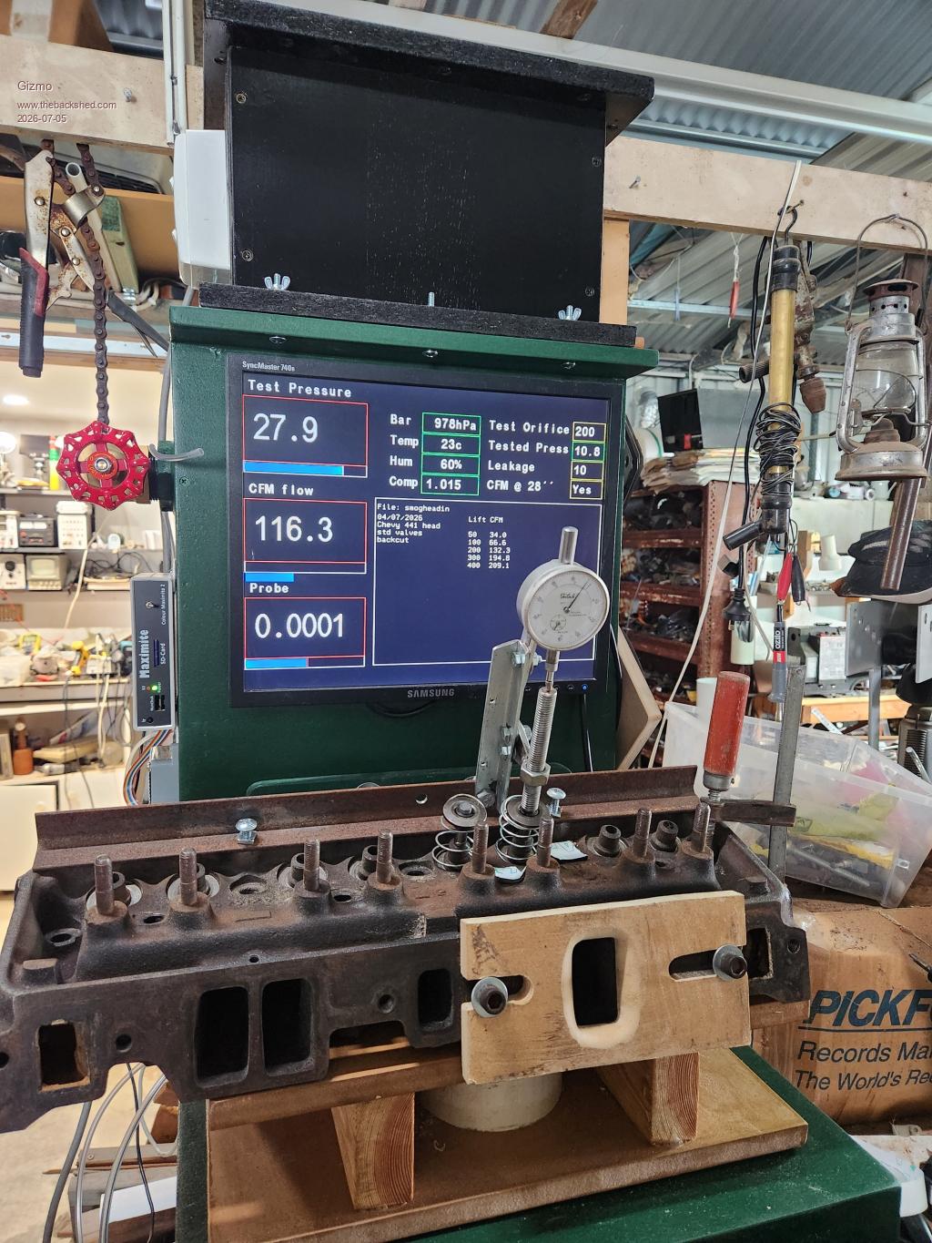

Recently I've been working on a set of heads for my old Monaro, and was using the services of another flow bench, but decided it was time to build my own.
This is my second flow bench, I built one back in the 80's when I played around with Datsuns.

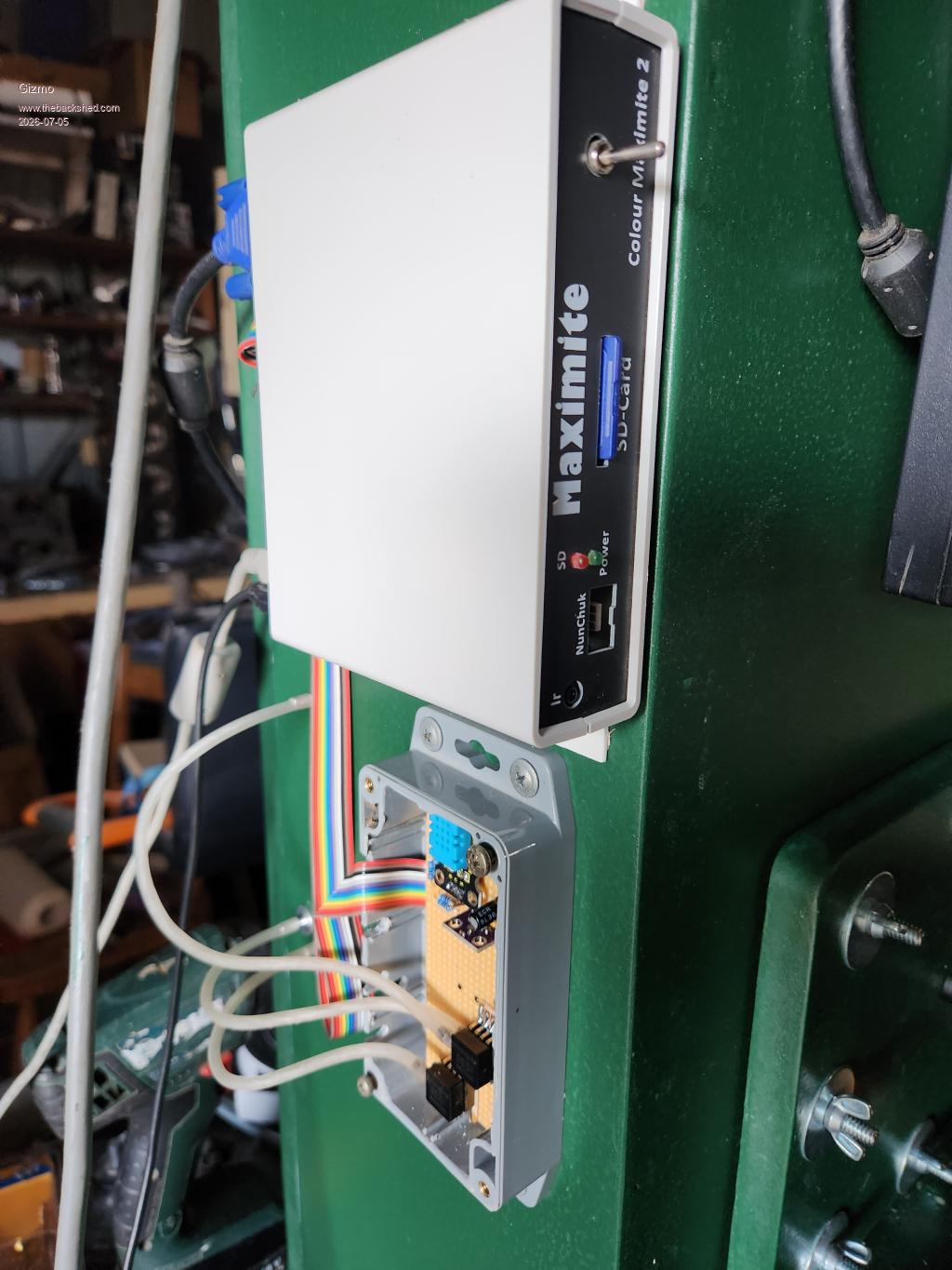

I wont go into details of how a flow bench works, other that to say it uses a few vacuum/pressure sensors, and "test orifice" used to measure the flow, vacuum motors ( 2 in my case ), humidity, kPa and temperature sensors to improve the accuracy, and a bunch of math.

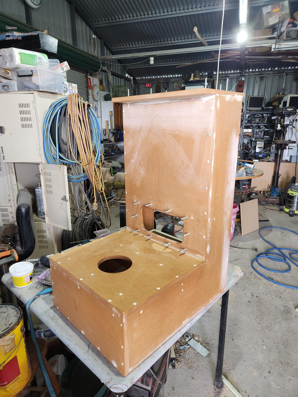

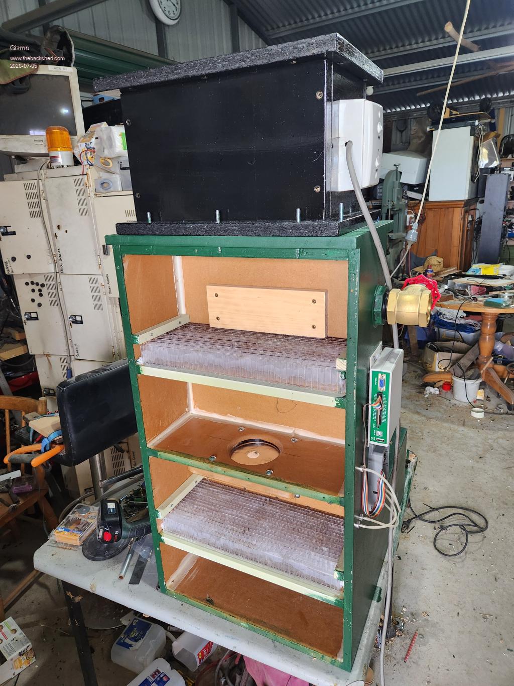

My bench is constricted from 12mm MDF. I used 8mm coreflute cut into strips and glued together to give laminar flow inside the cabinet on each side of the test orifice. The cabinet was sealed inside and out, then painted, as MDF is porous and leaks air. The air pumps are a pair of 1300 watts vacuum cleaner motors.
The code was written for a Colour Maximite 2 and is a work in progress. I used ChatGPT to help me write the function to get data from the barometric sensor MBE180, the rest is mine. Its not pretty, and still needs a lot of work. Usually when flowing something you are comparing it to a previous test, so the code can have a set of comparison data loaded as well as the "working file".
Eventually I'll document the whole project, but though I would share this for now.

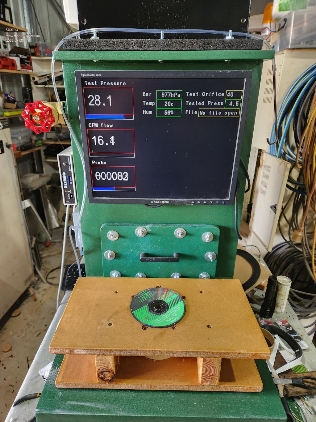

A CD is used as a standard flow bench test unit, 14.4CFM at 10 inches, This was before I calibrated the sensors. Calibration involves a bucket of water, a length of clear tube, and a ruler. Flow benches use 28 inches of water ( 1 PSI ) as a standard vacuum, but the software can calculate flow at a lower pressure.
flow.zip

Do you vary the motor speed to control pressure or is that what the 1-1/2" gate valve is for?
