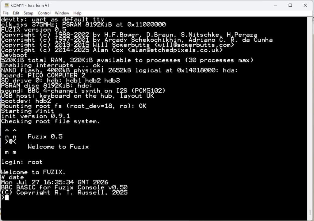

Posts: 11709
Posted: 05:13pm 26 Jul 2026
  Quote  However, the 64K limitation (which is presumably linked to its 8-bit heritage or the segmentation on the 8086/88) is certainly a drawback.
Fixed. USB keyboard and HDMI screen working so now has full "stand-alone" status. Next is to check/add applications - target is to have BBC Basic runnable
Edited 2026-07-27 03:13 by matherp

bfwolf
Posts: 11709
Posted: 03:54pm 27 Jul 2026
Here is the first release. Will run on the Pico Computer 3 or the Pico Computer 2 (HDMIUSBI2S)
fuzix.zip
FUZIX-PC3-MANUAL.pdf
Full blown Unix V7 on your rp2350 with lots of apps including BBC Basic
