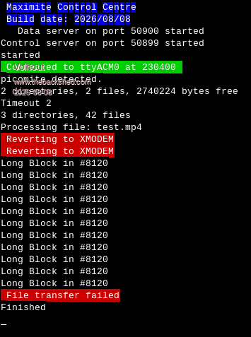

When transferring  large files (10Mbyte) from PC to Pico (V60300) drive B to PC I get "no response found" error messages at irregular locations.
Some times at low block numbers (800 or 3500), sometimes at almost makes it to the end (89000 blocks). On the LCD display it reads "too many errors".
I also see dollar signs on the MMCC terminal.
MMCC 537 works fine.
This is linux Ubuntu 20.04 on a 2GHz I5 laptop. If you value, I can try to image the PC to Ubuntu 24.04, and see if that improves. I think MMCC uses Xmodem. On the A: drive of pico I get messages "Ymodem not supported". Is that correct ?

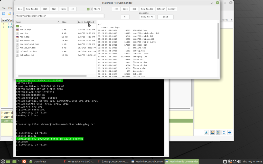

Tested on Ubuntu 20.04 this MMCC file manager works fine on 2040 and 2350.
Speeds on 2350 (mp3 file) was between 60 and 20 kB, on 2040 between 60 and 14 kB per second.
I tested large files, and multiple small files in batch copies back and forth.
Later today I will test the combination with MMEdit 542 (test if the complete IDE works).

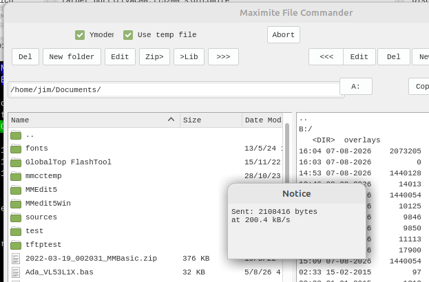

Does this speed look acceptable?
This is on Linux. Windows is slightly slower.
It does depend on the file type.
Tick the new option "Use temp file" and transfers to the 'mite will go to a temporary file then, when completed, rename to the target name.
Going to the PC will always use the temp file.

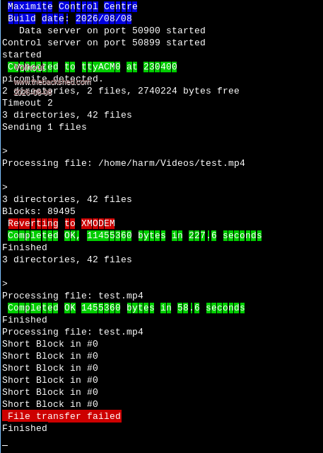

1/ The speed I achieve (on RP2040 GEEK running 200MHz) is 52kbps towards the pico. But that is back to "normal" since that is also roughly what 535/537 achieves.

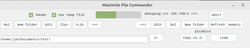

2/ One problem is that uploading back to the PC, there is in many cases no popup showing progress (see 4). I tried repowering GEEK, restarting MMCC, but there is no progress popup. In the end the file is transferred, but no progress.
3/ On large files, only part of the file is transferred. Exactly 10Mbyte is missing.
As you can see 11455360 bytes are transferred to B drive of pico. But trying to transfer this same file back to the PC indicates 1455360 bytes are transferred. And indeed, the file size on the PC is 1Mbyte (not 10Mbyte).
4/ maybe relates to issue 2. Above screenshot is taken on a transfer that disabled YMODEM (to force XMODEM). When you enable YMODEM, there is a double "reverting to XMODEM". The "long block" error messages are because I interrupted the transfer. They normally do not show. You simply get a message saying "finished".
So there is no progress popup on XMODEM when YMODEM is enabled, but XMODEM is selected anyway. But there is a progress popup when YMODEM is disabled.
P.S. speed from pico to PC is 25kbps.
