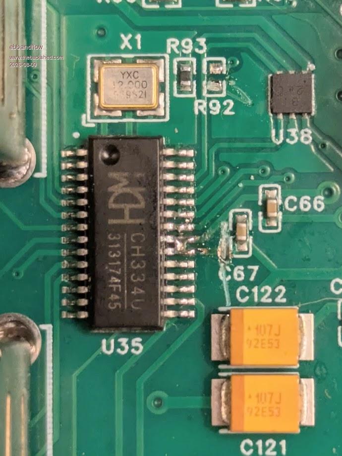

ebbandflow
Joined: 31/08/2023
Posts: 62
Posted: 02:34am 09 Aug 2026
I was finding the bottom of the case was fairly warm, and then stumbled across this post:
https://www.thebackshed.com/forum/ViewTopic.php?FID=16&TID=18919&LastEntry=Y#257894#257766
But after some minor brain surgery it's running cool now.
