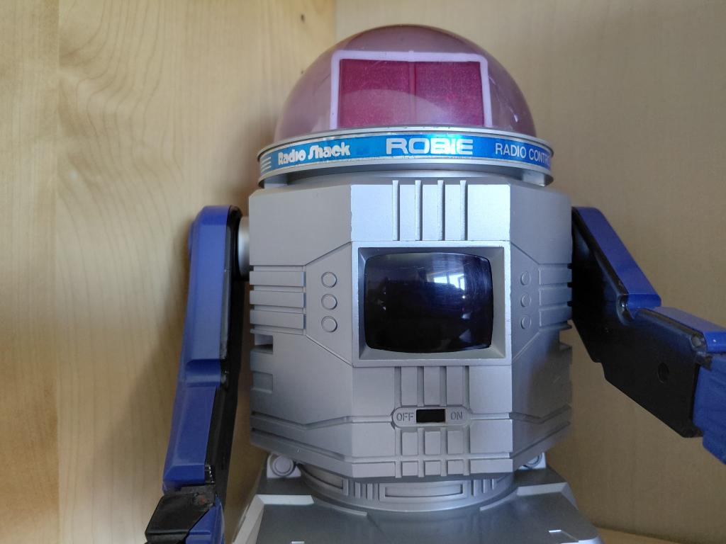

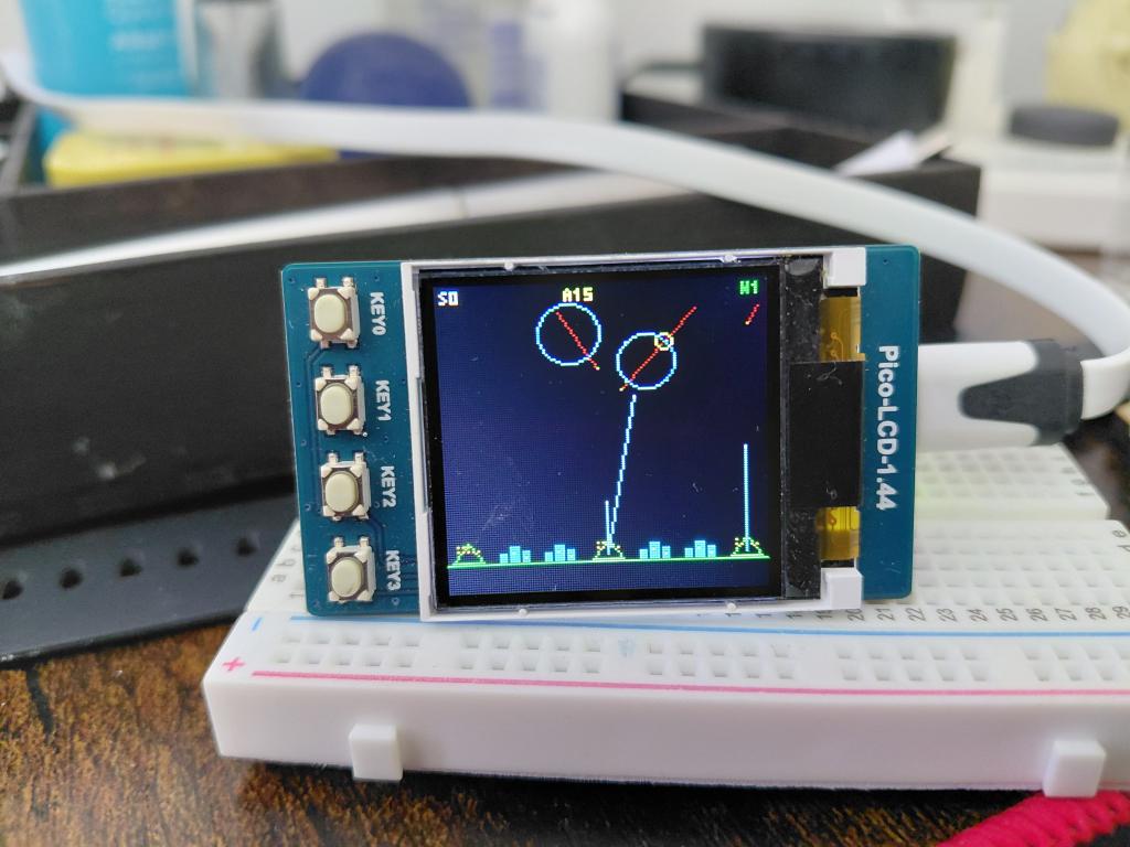

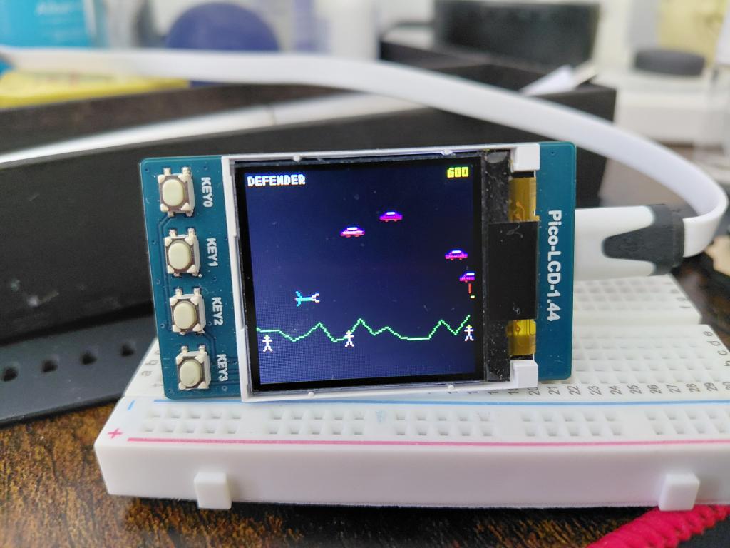

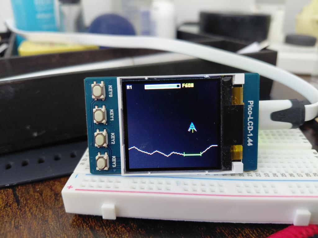

FWIW - the "games" are not real - in so much as the 'mite plays itself - there are no user inputs as I was going for the "look and feel" of these classic games - but they work in so much as the scoring mechanism and the game play is sort of like the real things.
The point of all this being to swap out the fake screen on this robot to a screen that cycles randomly through some periodish games and graphics...
