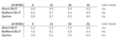

Because it was not clear from the beginning which design would be the best, I created three versions to compare them:
         Method            Engine                             Example Program
      1. Direct BLIT     bobemitter.inc                  SmokeEffect.bas
      2. Buffered BLIT bobemitter_buffered.inc   SmokeEffect_buffered.bas
      3. Sprites            bobemitter_sprites.inc     SmokeEfectSprites.bas
The first engine can handle unlimited particles with unlimited different shapes (at least in theory). The other two can handle unlimited particles as well, but only with 64 different shapes, due to the limited number of buffers.
The Benchmark of just the particle engine:
The Buffered BLIT and the Sprites reach the same performance because they are in principle the same. BLIT read/write are the same as SPRITE read/write. Due to this relationship you can use SPRITE transparency on a BLIT read buffer.
The drop in performance with real transparency happens because the transparency level have be calculated and set in basic. But this only concerns 12-bit color modes.
I thought SPRITES would be the fastest because they take care of restoring the background and don't need CLS in each frame. But I was not able to handle the massive overlap of the BOBs. All my attempts lead to ugly artifacts or other limitations. Maybe I haven't understood the SPRITE API and one of you have a solution for this problem.
