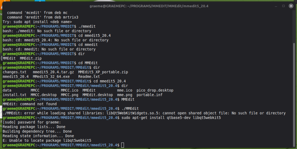

Just upgraded to LMDE7, and that all went smoothly enough, but now MMEdit won't run.
Trying to run it from the terminal, revealed that the libraries that MMEdit needs, were obviously removed during the upgrade.
I tried to add them back in the usual way, but LMDE7 reports that one of the packages no longer seems to exist.  Any ideas?
Is there a specific repository I should be including?

Try sudo apt-get install qtbase5-dev
(without the webkit)
And download the latest version of MMEdit.
In the latest version, I changed the way the help is displayed to avoid the need for the webkit library. It now uses the default web browser (hopefully).
I forgot to remove the webkit from the install instructions.

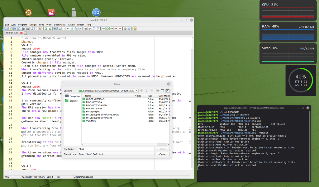

Downloaded MMEdit5, and this one when I try to run it, I get a blank window for about 1 second, then it closes.
Back to the terminal....
I CAN start it from the terminal, but NOT by just double-clicking the file itself.
Once open, everything seems to work, BUT if I close the terminal, MMEdit also closes.
I think I'm on the right track though, so it must just be some simple configuration thing at this point.

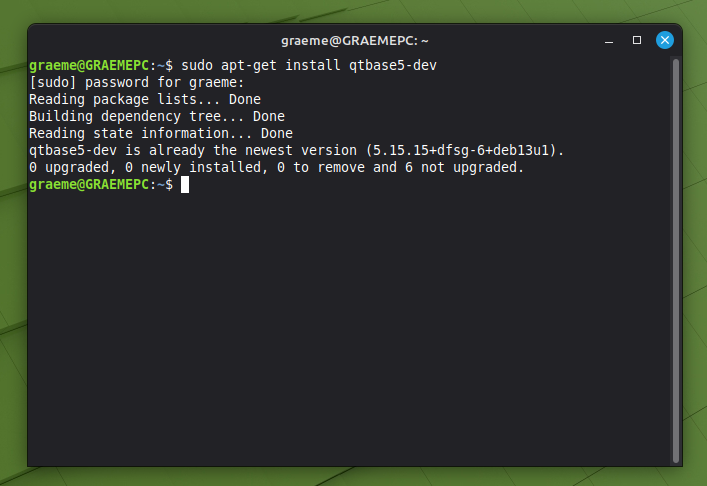

EDIT: Checked for the latest qtbase5-dev, and LMDE7 reported I already have the latest version installed.

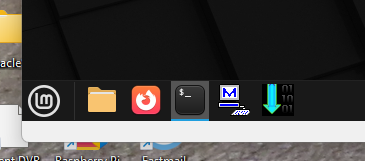

I used the icon file in the ZIP, so that the launcher icon on the desktop, has the official MMEdit icon for it, but when I open MMEdit, the icon on the panel stays as the default launcher icon.
Anyone know how to change that?
That's not an MMEdit specific issue, I have other launchers that have a selected icon graphic, but when they're open, they all show up on the panel with the default launcher icon, not the one selected for the desktop icon.
Not an issue really, but I would like to know how to change that if possible.
For example - GFXterm shows up on the panel with the green ">_" icon, and other panel icons are also whatever they are, so there must be a way to do this, but I have not found out how yet!

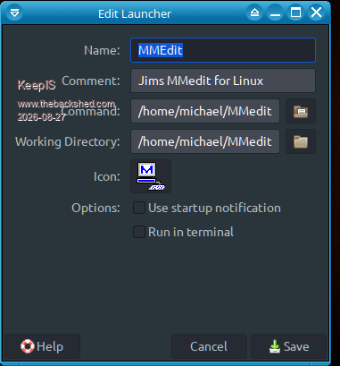

The Launcher in MX is below, navigate to the icon, select, and it always works, afraid I can't be of any help with why LM is having an issue.
