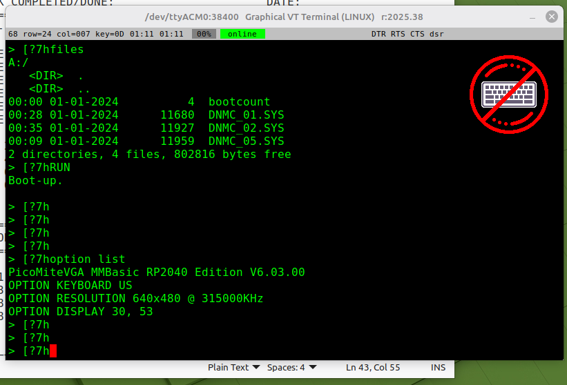

On all new FW versions of both the PM builds, this is the default command prompt.
What's up with this?
How do I disable it and just go back to the standard > prompt?
This is NOT visible on the VGA or HDMI output, but only on the console.
Is this something to do with advanced graphics control of the connected terminal?
I tried turning colourcode OFF, but it made no difference to the console prompt - it's still there....

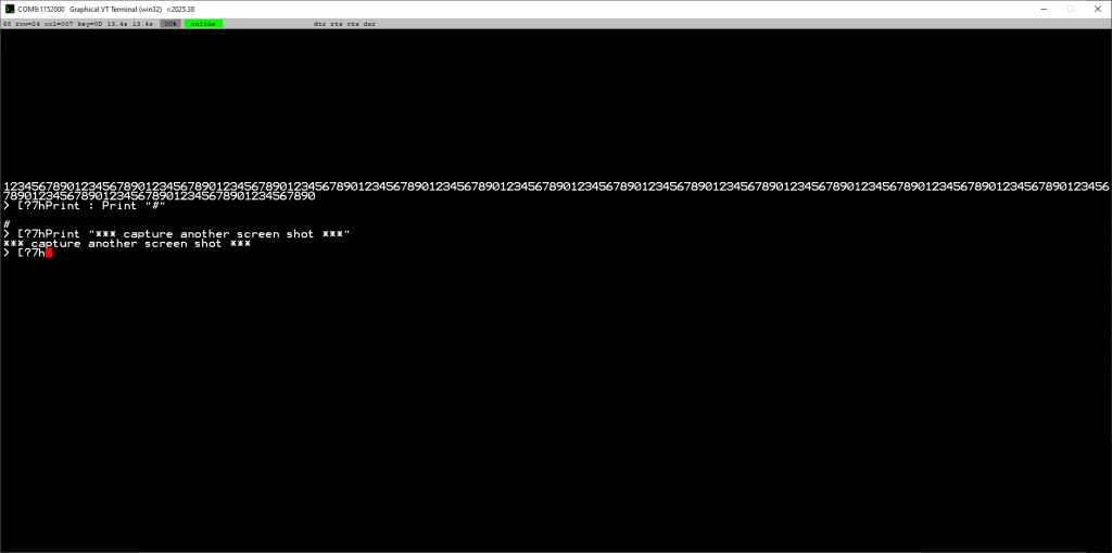

Posts: 10070
Posted: 11:30pm 28 Aug 2026
  robert.rozee said  however, i would expect you to also still see a ">" either before or after the "[?7h" text. can you please check this?
Before.  Here is an image:

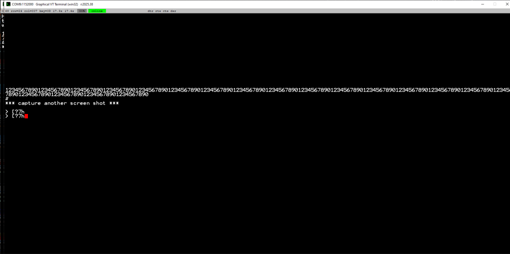

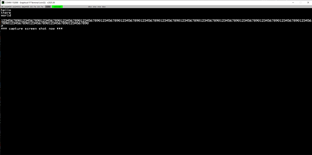

Posted: 03:22am 29 Aug 2026
hi Graeme,
   do you ever see "[?7l"appear? ie, with an "l" (lowercase L) instead of an "h".
i'm trying to figure out what Peter is trying to accomplish by adding in these escape sequences all over the place. try running the following test program (screen size set to 80x24), capturing screen shots where prompted and post the two captured images:

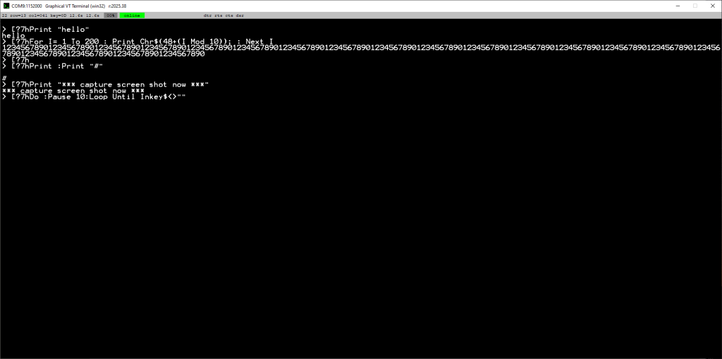

Posts: 3412
Posted: 03:57am 29 Aug 2026
Entered your program segments at the GFXterm command line (putting loops in one line).
Only "[?7h" sequences appear. No "[?7l" appear.
On Win10
In TeraTerm output is the same but without "[?7h" sequences.
Edit
Loading the whole program changes things.
This image was pasted over the previous one and was displaced a little so ignore the column of characters on the left.
Edited 2026-08-29 15:26 by phil99

ESC [H              ' Cursor Position at (1,1)
ESC [?1000h         ' Enable VT200 Mouse reporting
while the following when exiting the editor:
ESC [?1000l         ' Disable VT200 Mouse reporting
ESC 8               ' Restore Cursor and attributes
ESC [2J             ' Erase in Display, Full Screen
there should then be no need for mmbasic to ever send ESC [?7h. problem solved.
rob   :-)

Now ok in PicoMite MMBasic RP2040 V6.03.02b1
Posts: 10070
Posted: 11:56pm 29 Aug 2026
  phil99 said  Now ok in PicoMite MMBasic RP2040 V6.03.02b1
I assume that means that Peter is sorting this out.
I expect we'll hear from him in due course about this issue.....
