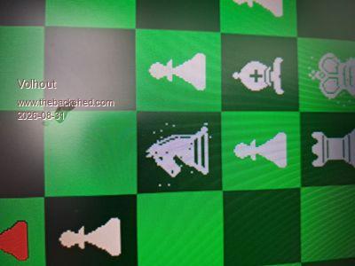

After 1 weekend running the ChessClient program (playing continuous chess games) the board this morning looked like this (check the horse). The photo is rotated (for some reason on the PC it was correct, before upload).

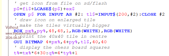

The Chessclient program uses this code, to read the chess piece tiles from SD card.
In other words, for each piece on the board, each move, each game, it opens a file, reads it, and uses the data. For 1000 games with average 53 moves, and showing 64 pieces (empty fields also) those are roughly 3.4 million file opens, reads, and close.
And the files on SD card are corrupted. I repowered the pico, and still the problem existed. Then I have copied new tile files from the PC to the pico (MMCC) and now the problem is gone. The SD card tile files where actually bad.
So files actually can get corrupt from just reading them too often.
Maybe it is a bad SD card. But this is just a warning for others, who may use similar technique for other applications. Just reading a file, does not guarantee it is never corrupted.

It si not very localized. If you look at the photo, you see that the king graphics (harder to see, at edge of the photo) also shows similar artefacts.
Not sure how the memory cells are geographically located inside the flash chip inside the SD card, but the file size is 256 bytes (containing 200 bytes of data). And there are 2 files corrupted (horse and king).
