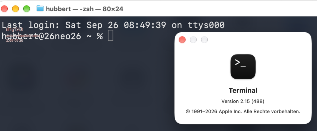

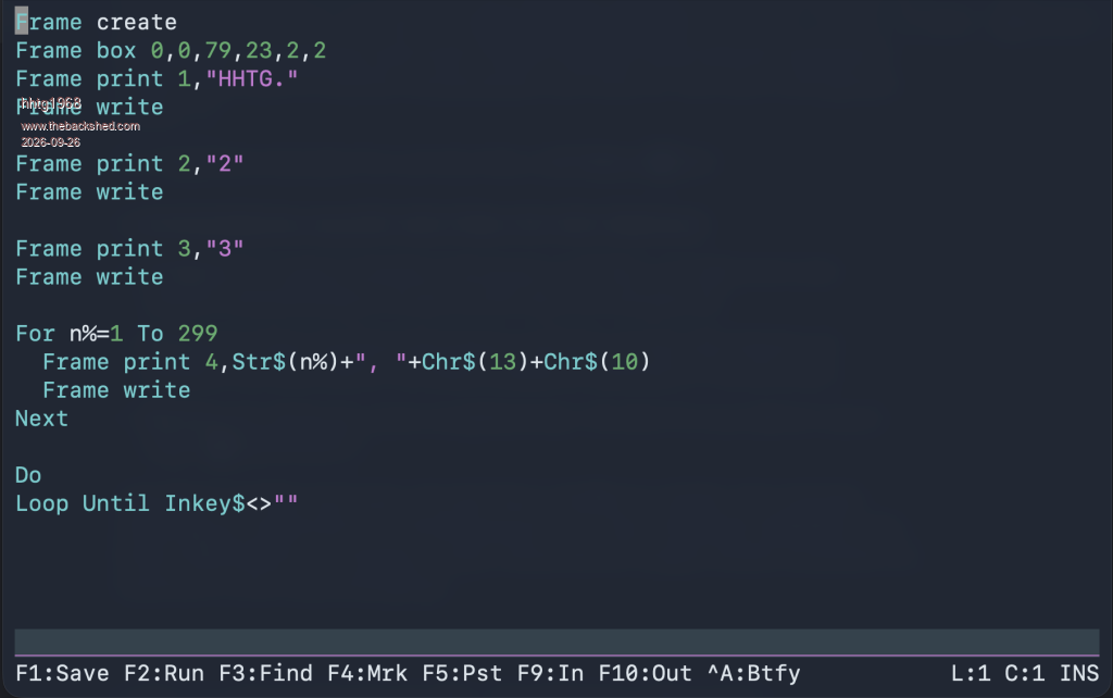

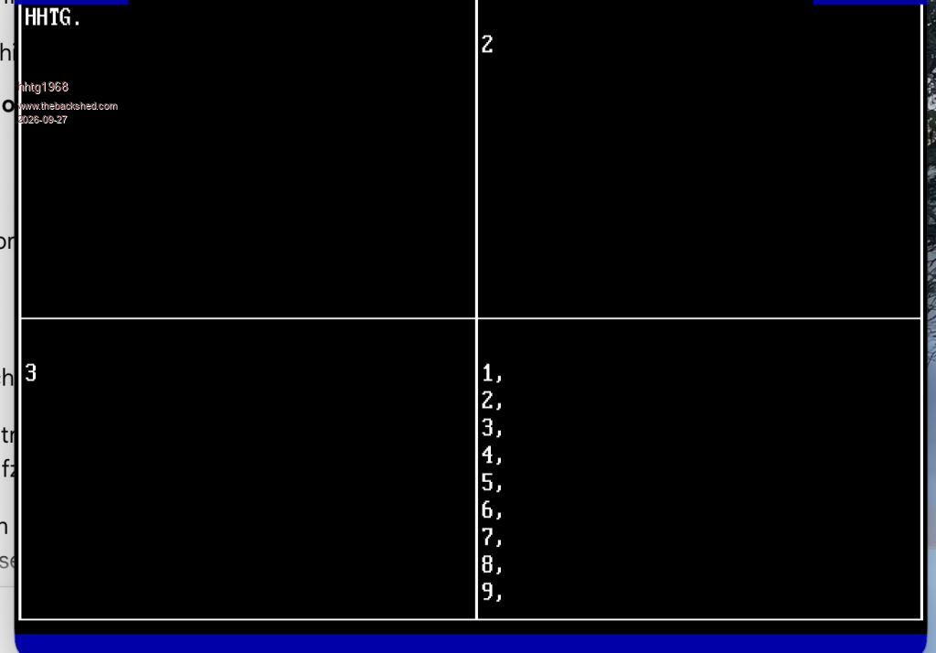

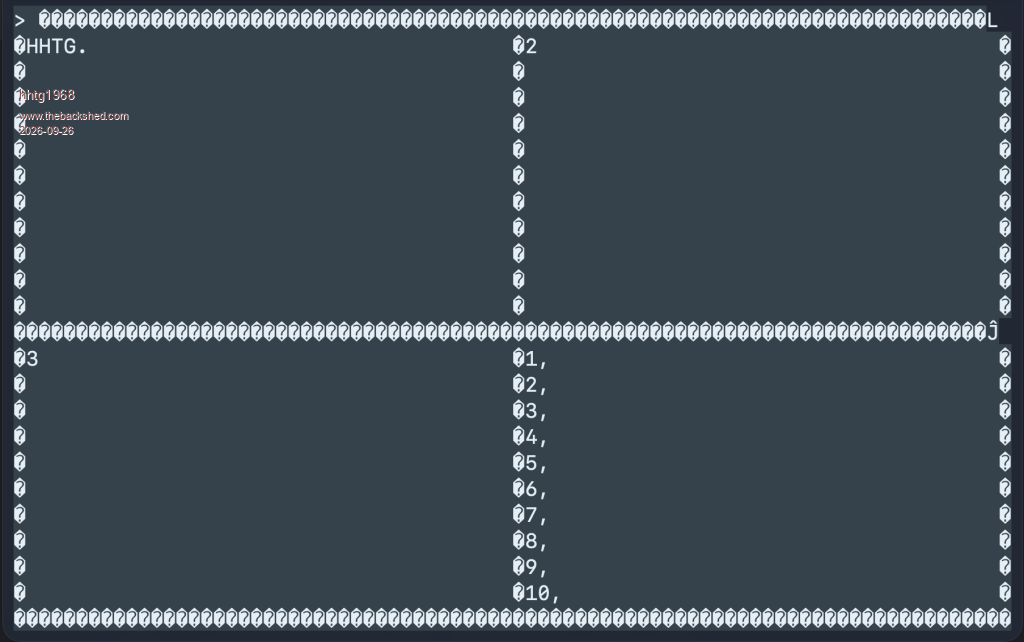

I tested the "frame" commands on my pico2 with rp2350 and mmbasic 6.04.00rc1.
my Shell (z shell (zsh)) on Macos uses the font "SF Mono Terminal". google gemini says this font has the "drawing boxes characters" but my little test program shows strange symbols.
I upload images wich show the .bas-file and the result.

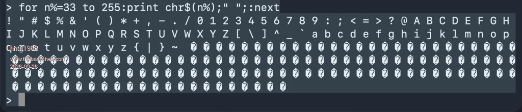

I also upload a picture of a test to print chars 33-255.
half of the chars are strange. is this a problem of ascii or utf-8? I am not a terminal specalist...
where is my mistake?
hhtg

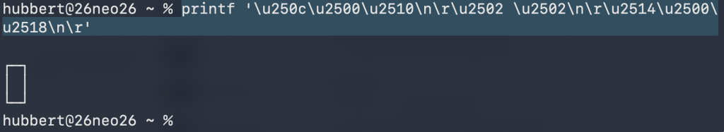

I thought my Shell does not print chars above 7bit (127).
but with printf in the shell i can show a box.
see the image:

OK, you're using zsh but what terminal program?
Also, what link - USB on the Mac?
Connected with a com port on the Pico or what?
I suspect it's the terminal program not liking whatever the Pico is sending.

  JohnS said  OK, you're using zsh but what terminal program?
I connected the pico via usb to my mac.
I use the standard Terminal App in Macos, look at the picture attached.

Does your terminal program allow you to select code pages?
You need code page 437.
Also, you terminal program might default to 7bit ASCII
You need 8 bit
Posts: 9220
Posted: 07:43am 26 Sep 2026
The font used on the terminal emulator is not the font that the PicoMite will display, they are independent. The Pico may display correctly on its own LCD, VGA or HDMI display while the terminal emulator shows rubbish because it's not got a font that has the necessary graphic characters (or, indeed, any characters at all) above chr$(127).
Posts: 4389
Posted: 09:40am 26 Sep 2026
printf '\u...'
is Unicode I expect, which the Pico won't be sending AFAIK.

If you can find a font that draws a box with
~ % printf '\u00da\u00c4\u00bf\\n\r\u00b3 \u00b3\n\r\u00c0\u00c4\u00d9\n\r'

Posted: 02:44pm 26 Sep 2026
hello. it depends on the terminal programm. macos does not want to use ascii or code pages, but only utf-8.
I tried several non apple terminal apps. some can use code page 437 an it runs...
have a look at the attached image...
from a programm called "syncterm".

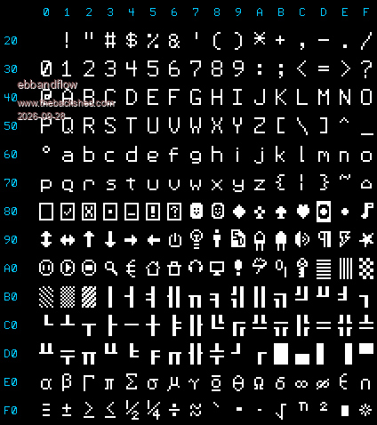

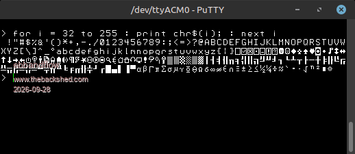

This topic caught my interest. I am also interested in installing a "Picomite Font 1" on my computer so the terminal output matches on-screen text output 1:1. Thanks for bringing it up!
I looked and did not find a suitable font here in the forum (but it may exist?) so I had my assistant    convert the font1.h file into a .ttf font file that should work on Win/Mac/Linux, but so far only tested on Linux Mint using puTTY. Attached is a .zip with the font, a .png of the character map, and the python script used to create the font file.
Let me know if it works out for you? I may post a separate topic for this .zip if it's useful
PicoMiteFont1.zip

Posted: 07:50am 28 Sep 2026
very cool...
but in the mac standard terminal app the utf-8-"limit" breaks out the chars over 7bit - >127
looks like on pico computer with direct screen.

Posted: 10:45am 28 Sep 2026
hhtg,
Thanks for the feedback. Sounds like the stock Mac terminal is utf-8 only, thankfully other options are available (like syncterm you noted).
