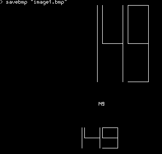

Here's a little routine I wrote this afternoon to display numbers on the screen, 7 segment format, in any size and aspect. I'm writting a little program to display windmill/solar data, and wanted numbers bigger than the standard font size. The future font commands Geoff is adding to the Maximite might make this redundant.
10: CLS
20: FOR i=1 TO 1000
30: Num=i : h=150 : w=40 : x=250 : y=10 : r=5 : s=10
40: gosub 1000
50: h=6 : w=3 : x=200 : y=200 : r=1 : s=2
60: gosub 1000
70: h=40 : w=30 : x=200 : y=250 : r=3 : s=5
80: gosub 1000
90: pause 100
110: next
120: end
1000: 'h = Numeric Height in pixels
1010: 'w = Numeric Width in pixels
1020: 'x = X axis start position, right justified.
1030: 'y = Y axis position, top edge of number
1040: 'r = Decimal point radius in pixels.
1050: 's = Spacing between numbers in pixels
1060: Numeric$=STR$(Num)
1070: StringLength=LEN(Numeric$)
1080: FOR StringLoc=StringLength TO 1 STEP -1
1090: line(x,y)-(x+w,y+h),0,"BF"
1100: n$=MID$(Numeric$,StringLoc,1)
1110: IF n$="0" THEN LINE(x,y)-(x+w,y+h),1,"B"
1120: IF n$="1" THEN LINE(x+w,y)-(x+w,y+h),1
1130: IF n$="2" THEN LINE(x,y)-(x+w,y),1 : LINE(x+w,y)-(x+w,y+(h/2)),1 : LINE(x+w,y+(h/2))-(x,y+(h/2)),1 : LINE(x,y+(h/2))-(x,y+H),1 : LINE(x,y+h)-(x+w,y+h),1
1140: IF n$="3" THEN LINE(x,y)-(x+w,y),1 : LINE(x+w,y)-(x+w,y+h),1 : LINE(x+w,y+h)-(x,y+h),1 : LINE(x,y+(h/2))-(x+w,y+(h/2)),1
1150: IF n$="4" THEN LINE(x,y)-(x,y+(h/2)),1 : LINE(x,y+(h/2))-(x+w,y+(h/2)),1 : LINE(x+w,y)-(x+w,y+H),1
1160: IF n$="5" THEN LINE(x,y)-(x+w,y),1 : LINE(x,y)-(x,y+(h/2)),1 : LINE(x,y+(h/2))-(x+w,y+(h/2)),1 : LINE(x+w,y+(h/2))-(x+w,y+h),1 : LINE(x,y+h)-(x+w,y+h),1
1170: IF n$="6" THEN LINE(x+w,y)-(x,y),1 : LINE(x,y)-(x,y+(h/2)),1 : LINE(x,y+(h/2))-(x+w,y+h),1,"B"
1180: IF n$="7" THEN LINE(x,y)-(x+w,y),1 : LINE(x+w,y)-(x+w,y+h),1
1190: IF n$="8" THEN LINE(x,y)-(x+w,y+h),1,"B" : LINE(x,y+(h/2))-(x+w,y+(h/2)),1
1200: IF n$="9" THEN LINE(x,y+h)-(x+w,y+h),1 : LINE(x+w,y+h)-(x+w,y+(h/2)),1 : LINE(x,y)-(x+w,y+(h/2)),1,"B"
1210: IF n$="." THEN circle(x+(W/2),y+(h/2)),r
1220: x=x-w-S
1230: NEXT
1240: return
You set the numbers width, height, spacing, etc. The x position is the left edge of the right most number, and the routine will right justify the number. The top few lines are just to increment the number for demo purposes.

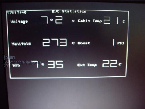

Posted: 10:41pm 24 Jul 2011
Hi Glenn
This works really well thanks
Seems to be 1 small bug if the number to be displayed
changes from 3 to 2 digits or 2 to 1 digit the left most digit remains
on the display.
Ie if we display 99 then 100 then roll back 99 the display will
be 199
Any thoughts or have I done something dumb
jman
Joined: 12/06/2011
Posts: 711
Posted: 05:20am 25 Jul 2011
Hi
Found a way around it. If we format the number to the max required length
the blanks are added as per below

Picture of the work in rogress

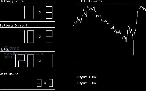

Posted: 08:36am 25 Jul 2011
Hi John
Glad to see you worked it out.
This is what I've been using it for.
