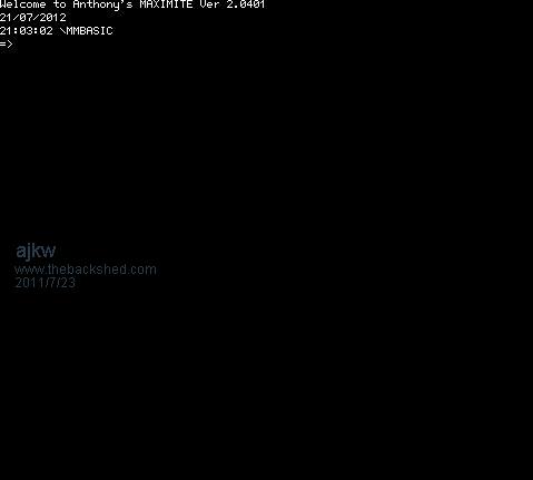

I see in the new firmware update 2.4B that you can now read from a digital output pin. That will get me back to 3 pins which was the problem to which I originated this thread. I am sure the ic2 guys will be happy to have an official release also.

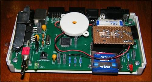

The DS1302 has been working away nicely and I have the board nicely secured inside the maximite case. If any one would like to give the DS1302 a try and do some programming using an SPI interface I am happy to provide a copy of the code and further pictures. Attached is a picture at the conclusion of my autorun. My prompt is 2 lines, the time, the current directory and the actual prompt on the second line.
Cheers,
Anthony.
PS. The screen shot is a couple of days old. I should have done another one and uploaded it instead.Edited by ajkw 2011-07-24

Some vero board, with the DS1302 on the underside, a CR2 battery and plenty of hot glue to hold it in place. The power and data wires go through a (new) hole in the main board near the keyboard connector and are soldered to directly to the I/O pins of the right angle connector.
Cheers,
Anthony.

I now also use the 31 bytes of GP Ram also.
Cheers,
Anthony.
