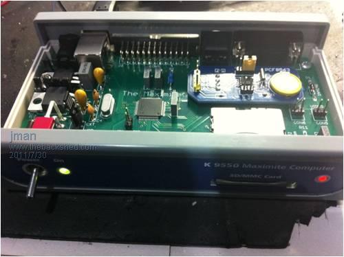

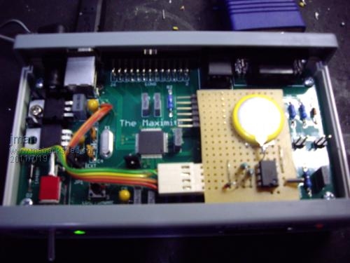

As per the other RTC thread I have managed to get my RTC inside the orginal case.
This really cool as now when I power up the time and date is always correct.
This requires Gerard's I2C firmware
I have included the circuit diagram for reference (straight from the datasheet)
2011-07-19_174444_RTC.zip

Posted: 12:16pm 19 Jul 2011
Yeah I agree, nice work.
I think the Maximite II should come in a bigger case. Its a bit of a squeeze in there.

Thanks for this contribution John. Having reached the point of being annoyed by having to enter the date and time via my autorun.bas file I'm delighted you have made this available.
However, sometimes I'm fairly thick (and extremely thick for the rest of it) and need advice about where the circuit diagram is. The ZIP file contains two sets of code, but no schematic.
BruceEdited by brucepython 2011-07-21

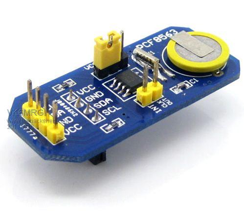

jman
Joined: 12/06/2011
Posts: 711
Posted: 08:08am 20 Jul 2011
http://www.ebay.com.au/itm/PCF8563-RTC-Board-PCF8563-I2C-int erface-3-3V-battery-/250846999759?pt=LH_DefaultDomain_0&hash =item3a67a574cf
That links works
Looks very good for small price
jman
Joined: 12/06/2011
Posts: 711
Posted: 08:18am 20 Jul 2011
Hi Matt
I have ordered one
Once it arrives and I have it working I post the results.

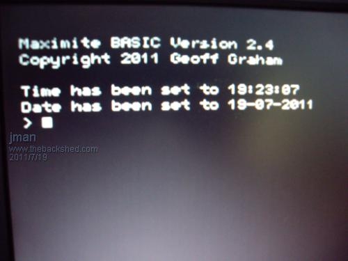

Attached is the code I used
Remember to run the wr8563 after setting the correct date and time on the Maximite
2011-07-28_171338_PCF8563.zip

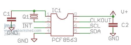

Hi can you provide Pic on how to wire it in?
Heppy
jman
Joined: 12/06/2011
Posts: 711
Posted: 08:20pm 29 Jul 2011
Hi
This device is connected just like any other I2C device
Pin 12 maps to MCU pin 43 (SDA1) and pin 6 on the I/O connector (revised schematic) or pin 21 (original schematic).
Pin 13 maps to MCU pin 44 (SCL1) and pin 8 on the I/O connector (revised schematic) or pin 19 (original schematic).
The PCF8563 has built in pullup resistors to the VCC line so no need for those
You can get +5V from I/O connector pin 23 (revised schematic) or pin 3 (original schematic). A ground will also have to be run to the I2C device (I/O connector pins 1,2,25,26).
This device will also run from 3.3V in that case pin 24 (revised schematic) or pin 4 (original schematic)
Hope this helps
Attached is a circuit diagram ofr the PCF8563

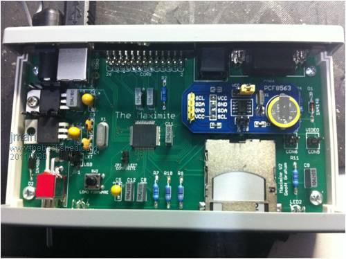

Hi
I have removed the vero board version and installed the PCF8563 Ebay version inside the case
Looks just like a bought one :)

Posted: 09:55pm 29 Jul 2011
Thanks Heaps (Looks like it was made for it)
Heppy
