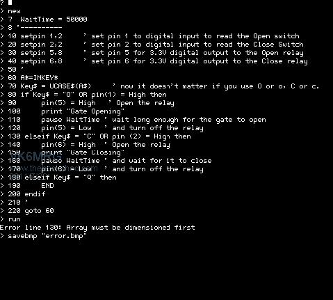

I cut and pasted the program you made up and tried to run it and came up with this error. Any clues.
Its easier to ask forgiveness than to seek permission!
............VK6MRG.............VK3MGR............
James_From_Canb
Joined: 19/06/2011
Posts: 265
Posted: 01:40am 23 Jul 2011
  VK6MRG said   James,
Yep. My bad. Get rid of the space between pin and ( on line 130.

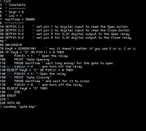

Ok, hear it is so far, Thanks James.
Now I need to add a stop button and stop in the software, so I can type s and stop the program and a switch for gate opened and a switch for gate closed. This is to act as a limit switch, so that if the gate opens faster than normal (battery and solar setup, so if battery is fully charged the actuator will run a bit faster) the limit switch will end the open or closed sequence.

James_From_Canb
Joined: 19/06/2011
Posts: 265
Posted: 03:58am 23 Jul 2011
  VK6MRG said   Ok, hear it is so far, Thanks James.
What happened to using constants for High and Low? It's your program, but it's difficult to read because I have to keep translating what 1 and 0 mean.

Ok, I’m getting there.
This is the code to date. I configured the relay logic to suit the 1 and 0 states and got it working as it is but I can change that.

10 setpin 1,2 ' set pin 1 to digital input to read the Open switch
12 setpin 2,2 ' set pin 2 to digital input to read the Close Switch
14 setpin 3,2 ' set pin 3 to digital input to read the Opened switch
16 setpin 4,2 ' set pin 4 to digital input to read the Closeed Switch
30 setpin 5,8 ' set pin 5 for 3.3V digital output to the Open relay
40 setpin 6,8 ' set pin 6 for 3.3V digital output to the Close relay
50 '
60 A$=INKEY$
70 Key$ = UCASE$(A$) ' now it doesn't matter if you use O or o, C or c.
80 if Key$ = "O" OR pin(1) = Low and pin(4) = Low then
90 pin(5) = High ' Open the relay
100 print "Gate Opening"
110 pause WaitTime ' wait long enough for the gate to open
120 pin(5) = 0 ' and turn off the relay
130 elseif Key$ = "C" OR pin(2) = Low and pin(3) = Low then
140 pin(6) = High ' Open the relay
150 print "Gate Closing"
160 pause WaitTime ' and wait for it to close
170 pin(6) = 0 ' and turn off the relay
180 elseif Key$ = "Q" then
190 END
200 endif
210 '
220 goto 60
So, if the gate is open and you press "o" or the open button, nothing happens!
If the gate is closed and you press "c" or the close switch, nothing happens!
