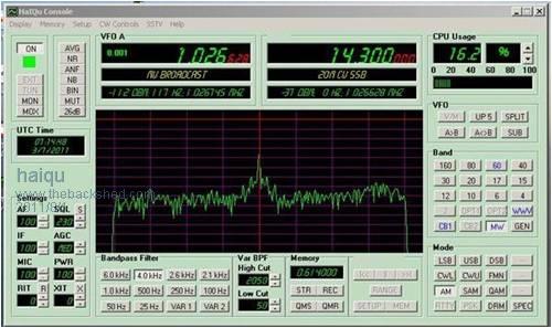

Actually that's pretty much in line with one of my applications. I've been running a FlexRadio SDR-1000 since 2003 but it would be nice to prise it away from the PC and go mobile occasionally. I'm doing the DSP stuff in an Altera FPGA.

Here's an idea of what I'd like to achieve with it. Of course it wouldn't be written in BASIC ...
Sorry about the green background, it was an experiment.
