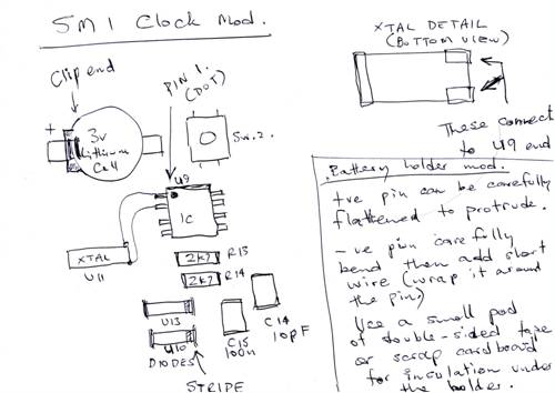

Rather than include instructions on paper, I'm uploading them here for anyone to use:
unzip, strip, touch, finger, grep, mount, fsck, more, yes, fsck, fsck, fsck, umount, sleep

For those who are about to receive parts kits:
The 10pF capacitor is marked with a black texta so you can tell which one it is. They looked so similar to the 100nF caps that I had to distinguish it somehow.

Got my parts today...Another first for me as i havent done surface mount before...;-)
Is there a schematic somewhere which shows you the rtc circuitry...???

Posted: 10:03pm 01 Sep 2011
Hi Frank,
It's on Don's website as I recall. One thing I found was there was way too much solder on the pads. Clean most of it off with soderwick, tag one end with the iron then solder the other end, and finally go back and fully solder the first end. You'll need tweezers, a clean bench and a maggy lamp, at least if your eyes are as bad as mine.

haiqu
Joined: 30/07/2011
Posts: 152
Posted: 10:06pm 01 Sep 2011
Oh yeah, and if you go back one page there's a layout of the parts on this thread that I posted a few days ago, just in case you happened to miss it.
