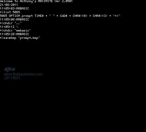

Posted: 01:41am 21 Aug 2011
Geoff,
I have only noted this curiosity since loading this version but may not be actually related to just this version. It however seems to relate to string handling within the option prompt command.
In the attached screen shot you will see I set the prompt in line 5065 of my autorun program.
Careful study of the prompt shows that when the current directory is the root directory there is a space between the time and the \ but when set to a directory the space disappears.
Cheers,
Anthony.
