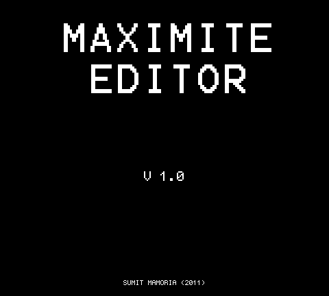

This is my first attempt to a very basic MAXIMITE EDITOR. It was coded in a very short time, so it may need optimizations.Sorry for not adding the comments to the program. Will do it soon.
Currently runs on version 2.6A onwards. Remove line numbers : 1010,1060,1090 for earlier versions.
Program file and a short manual are attached.Please read the manual before using.
Please report the bugs.
This is the Home screen...
