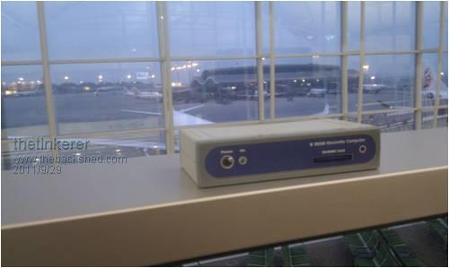

Just an idea. I am currently travelling with my maximite! and when typing in a command and typo is made there is no backspace at the command prompt. An example would be if we type load"..." and make a mistake the whole line has to be retyped or is this that only occurs through using putty?
just a thought and thanks.
Marc
PS: here is the maximite at Hongkong airport:
The maximite has now been powered up over mongolia at 35000ft and has visited the London bridge, and Paris!

I love it, the Maximite travels the world !!
