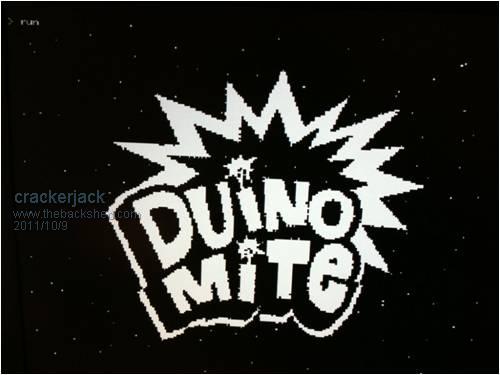

Hi All,
I have a small program that allows me to display bitmap images loaded from the SD card. Of course monochrome images no larger than 480x432 pixels are the limit (and it is painfully slow), but it was a fun exercise learning about the BMP format and how to read it from a file & decode it using MMBasic. Attached is a photo of a bitmap loaded from the SD Card (Don, I hope you don't mind me using the Duinomite logo as a test case). It may be of some use if you want to display small images as splash logos, etc.
If anybody is interested, I can post the code (I'll have to clean it up a bit first).
Lance.
Actually it is an Olimex generated Logo, but I'll stick my neck out and say they are more than happy for you to use it.
Nice work.
Cheers Don...

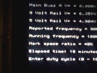

Posted: 05:20am 10 Oct 2011
heres a pic for you guy`s
technicians do it with least resistance

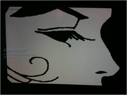

Just for the sake of completeness - here is a final version - refactored somewhat now that I better understand the BMP format's padding spec.
There are some diagnostic details still printed by the code which could be removed to make it more compact (since the CLS at line 280 wipes them out). 5% of program memory is used by this version of the code.
I am thinking there may be a better, more quickly rendered format for raster graphics specifically for the Maximite... I may look into what this could be. Code follows along with another screenshot.
