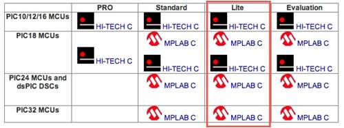

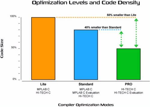

Vasi,
This is interesting but with Microchip now releasing all their compilers in essentially free mode (lite mode) what is the advantage to another open source compiler that needs work?
The only restriction in the Lite version is limited to 1 level of optimization. Other than that they are full compilers with support for all parts.
I don't like optimization anyway. It shifts the code around. I'd rather just use a larger memory PIC.

Yes, I said that too in a discussion with another person (today C18 is the best free C compiler for PIC18F) but the point of Pinguino project is to use a totally open-sourced development chain. The only really weak part of 8bit Pinguino project was always the SDCC compiler, forcing the developers to make a lot of tricks regarding to USB bootloader. Now, we have cpik which can be a successful project if it will gain a lot of attention. And it have the chance to become better than C18 compiler of Microchip.
P.S. Arduino free and open-source movement forced Microchip to release a non-restricted, full optimized C32 compiler!!! We can force an analogy? Not yet but with help from volunteers it can be possible.
P.P.S. Of course, the Pinguino 8bit project can be forked and can use C18 instead of SDCC but needs also volunteers.

The optimization can be for speed or for size, as you know. In the real world, both are important.
Size matter if your boss don't want to spend money to change the entire line based on an old microcontroller but it ask you more features (you do it or you leave). Of course, that boss don't pay a cent also for the programming tools...
JALv2 compiler produce very good size optimized code for PIC12F/PIC16F microcontrollers. But the best for code size is the C compiler from "B Knudsen Data", CC5X but the disadvantage is that is not ANSI C and you have to take care of bank switching so, better use JALv2.
The size also matter when you need a small USB bootloader and that means more space for user applications - an advantage over the other boards from the market.
The size also matter for MMBasic project. We will see that on DuinoMite boards.
The smaller you microcontroller is, the bigger is the need for compact code.
Or speed matter if you have a similar product with the one made by your rivals.
  wizard said
Does optimization really do anything useful?
Wiz
Yes, I strongly believe that! Specially when you produce affordable educational tools.

Let say we have an 8bit Pinguino board (based on 18F4550). I can't have the same full featured JALv2 application (which occupy 100% the flash) written in Arduino language (using Pinguino IDE and SDCC C compiler) because there are huge differences mainly in the size of the code produced by the compilers. Also, from the start, Pinguino board come with much less user application space if I use the Pinguino USB bootloader against JAL USB bootloader. 6Kb difference in a total space of 32Kb.
Comparing them, we can say that the optimizations in SDCC compiler are a bad joke (of course, that is unfair for the developers of the PIC support for SDCC but I can say that now they have a very promising alternative ).
Now, I can't say again that the optimization does not matter.
Not even if I compare with PIC32 because there, I will use applications which occupy the same percent of flash for analysis (as I said before, MMBasic, retroBSD, etc...).
Vasi
P.S. BTW, the high optimization of JALv2 compiler helped me to fit inside PIC12F675 (1KB flash) one additional feature than using PICAXE8M as Windmill logger. I can't find PICAXE8M in my country and you can't get too easy a PIC12F683 (wasn't available at the project time)...
Another thing which helped me, was that I had the full sources of the libraries from the Jallib project (a team which develop JAL libraries for a large variety of peripherals and sensors) and a modification in the source helped me to fit the code.Edited by vasi 2011-10-15
