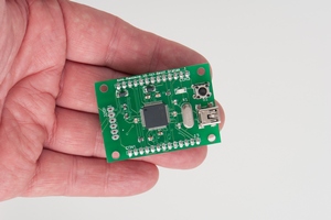

For anyone who is interested, the magazine describes the mini Maximite, which is about the size of a large postage stamp. This does everything that the full sized Maximite does except that the connectors for video/keyboard/etc are not included. You can wire the connectors to the board but it is really intended as a plug in module to add intelligence to your creation. The idea is that you develop on the full sized Maximite and when you are ready, copy the program to the mini Maximite and plug it into your circuit.
The new feature in MMBasic 2.7 is that you have two "disk drives", drive A: and drive B:. Drive B: is the SD card on the full sized Maximite (and the mini version if you wire an SD card socket to it). Drive A: is a 256KB "disk drive" created from the internal flash memory of the PIC32 - you treat it the same as the SD card, ie, save files, run programs, list files, etc. The only difference is that you cannot create directories.
This internal drive means that the mini Maximite does not need an SD card when it is used as an embedded controller, but you can still run programs, log data, etc. By the way, this firmware also runs on the full sized Maximite, so you get drive A: and B: on that also. To copy files to and from the internal drive ver 2.7 adds support for the XModem protocol.
There is a separate version of 2.7 for the UBW32 board (sold by Don) so it also gets the internal drive along with support for 50 I/O pins.
Amazingly I have not seen the final copy of the article but I understand that Silicon Chip were going to include a box in the article offering to sell the PCB and programmed PIC32 chip. There are only a few additional components so it would be an easy build. I don't know if Altronics will be producing a kit but they would be silly if they did not.

Just wondering why the PCB has no provision for a 3.3v regulator to power the PIC when using the USB connector to setup the Mini Maximite for whatever function.
I know that a few are going to use it for a remote data logger and also remote controller for wind, pumps, etc. So to have the option to add the 3.3v regulator if required would have been a big advantage with no extra cost per PCB, just a few extra tracks and pads etc.

I thought about this in detail. Firstly, as an embedded controller the mini Maximite would rarely be plugged into USB, so you could not rely on 5V being present. Secondly, the circuit that the Maximite was being plugged into would probably have a variety of voltages available and 3.3V is easy to generate, even if it is not there.
Remember that you are supposed to use the full Maximite if you are just playing around and that can be powered from USB.
I did not think of making the regulator optional and that would have been a good idea. The main issue is that kit manufacturers like Altronics tend to add optional features into their kits anyway and with their 4.5 cost multiplier adding a few parts that cost a few dollars will inflate the final cost of the kit by a lot.
Something like this is a tradeoff and I guess that my take on it will not always suit everyone.
