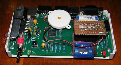

Posted: 02:46am 05 Nov 2011
John,
I used this speaker. Its frequency response is ordinary but it certainly adds sound to my Maximite.
I also replaced the resister with a link to get some volume out of it.
Cheers,
Anthony.

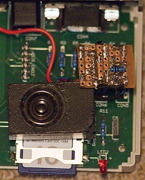

Laptop speakers are pretty compact. This one is from a retired MacBook and is driven by an LM386 mounted upside down on the veroboard. The board plugs into CON6. One day I'll do a combined board with the RTC and the audio so it can all plug into CON3 (for power) and CON6 without ugly flying leads. The speaker is thin enough to be anchored to the SD socket with some double-sided tape.
BruceEdited by brucepython 2011-11-06

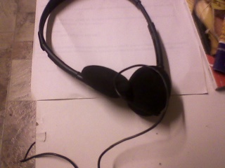

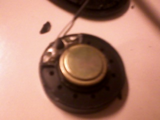

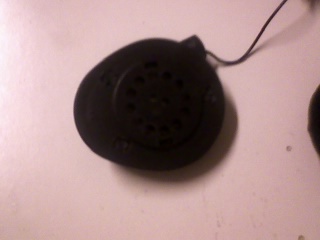

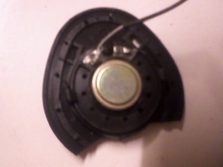

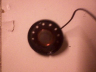

try places like "element 14" or "rockby" altonics and jaycar may have something "the go co" um you could try tandy but i think they have been bought out and dont even stock such devices ...try dismantling a set of head phones the type you get for free on the airlines ...that might be of some advantage ...not those tiny things but ones that have like one inch speakers in them...///...///
i dont really think that the impeadence will be that great of a problem
also i agree with what glenn had to say about a lot of pizeio drivers having an internal circuit because they are made that way so that they will produce a high pitch sound...///...///
here are a set of small cheap head phones which i have broken apart using only
a small flat blade screwdriver this speaker is very adequete...///
Edited by sparkey 2011-11-06

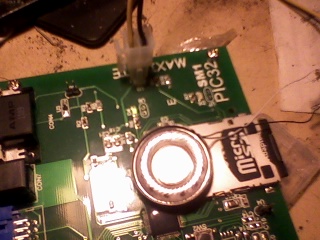

Posted: 11:54am 05 Nov 2011
sound works with the head phone speaker...///...///also note the resistor that has been deleted as per earlier in this thread ..will increase output but i have a very low tone comming from speaker from head phone dismantled ..i have not jumperd the resistor ....///...///just yet...///...///its r"8" on the SM1 board...///...///abouve r"10"...///...///
and here i have a connector from a "P4" power supply i had to spread the pins a little wide so it would fit the connectoras well as having the speaker out of the set of head phones it works...///...///
