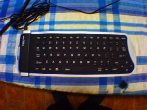

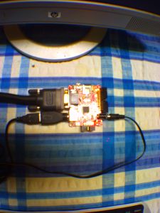

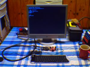

Anyway I recieved my Mini-Duinomite and brought it up on USB.
Today my flexible keyboard arrived so I used the black USB-PS2 adapter that came in the pack and borrowed a HP display off a son and wired up a Power supply. Everything came up and it all works a treat. No Problems what so ever.
Duinomite with both keyboard adapter and VGA connector. Tight but no problems.
It's a small keyboard.
The setup running while I check everything was OK.
Sorry for the not so good photos. The keyboard is a TomTop TASJ05 USB/PS2 flexible keyboard I found on Ebay. It has ST1212 written on the keyboard's left side as well.
Hope it helps. Many thanks to Geoff and Ken for the ability to run the keyboard.
When we were laying out the dynamite boards, I told Tsvetan that we needed to get the VGA and KBD connectors as far apart as possible, so that we can use the little adapters.
Because the DM-mini was tight, I didn't think we had room to do this, but he has left just enough to make it work.
I tried several combinations here, and all worked. Some were tight, others had plenty of room.
Glad to see you are moving in one direction. AHEAD!
