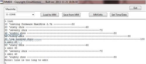

Thanks Guys, I have one now and tested it on V2.7b:
Yes, 80 chrs.
Cheers Don...
